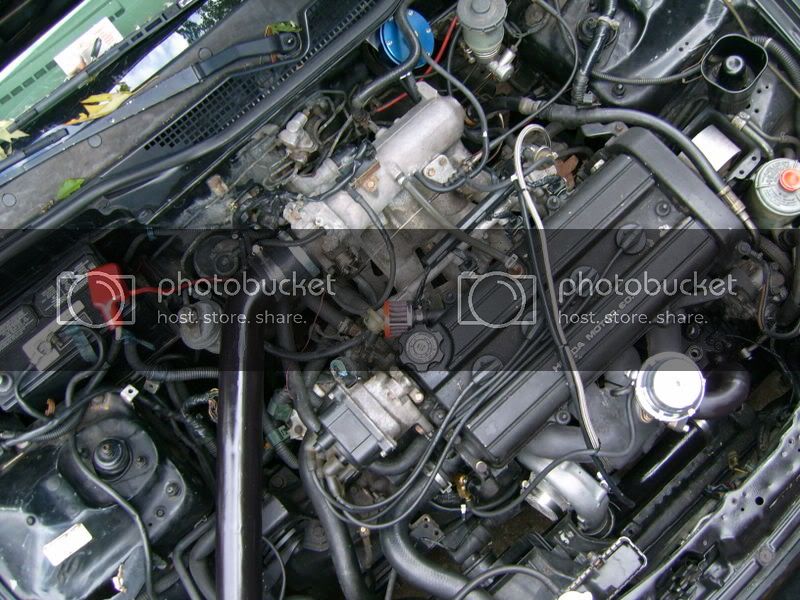

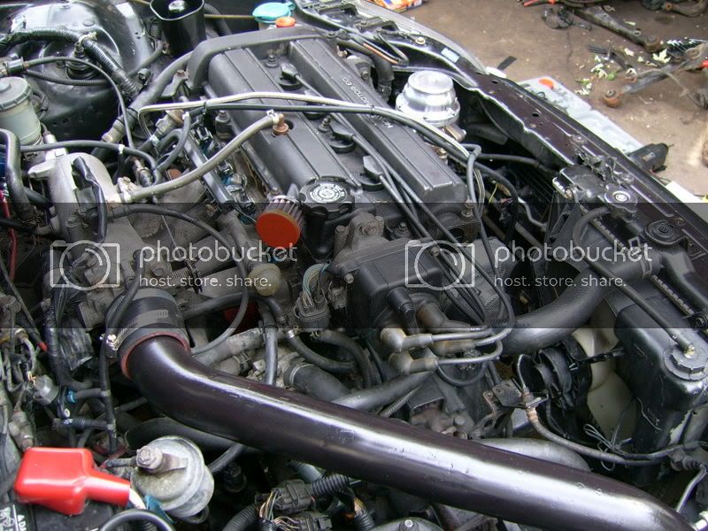

    A couple of shots of my civic. I know the pics
    are gay, but fuck it.[​IMG]
    anyways...
    I just got done installing a homemade turbo in my fodo'.
    Its a b18b engine (stock) with a 57 trim
    t3t4 turbonetics turbo.
    Most of the turbo parts were bought at local shop and forums.
    It took me 4 days to get this thing rolling.
    I spent about $1100-1200 for this project including
    a couple used gauges (boost and oil press). Thanks Ripperbone.:)
    Not too shaby compared to almost 3 grand i spent 2 years
    ago for the drag3 kit. This is pretty much the same shit
    for half the price.
    I'll be tuning it with crome.
    Here she is. My sleeper 4 door. WHat do you think? Do i look gay
    in the last pic? lol
    edit: The intercooler is now painted black. ALso bought a Tial BOV and mounted it 6" from the turbo.

    can't really see your setup in those pics but the car looks nice
    why did you put the BOV so close to the turbo?

    umm....the blow off valve is right next to the throttle body...ur seeing the wastegate near the turbo.....just lettin yah know

    nahhh... Thats an old pic. That BOV you see is a bullshit ebay one. The one i have now is a Tial BOV and is closer to the turbo.
    Pics up in a bit. Hang on.:p

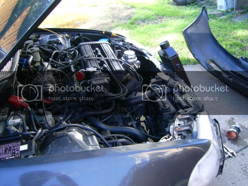

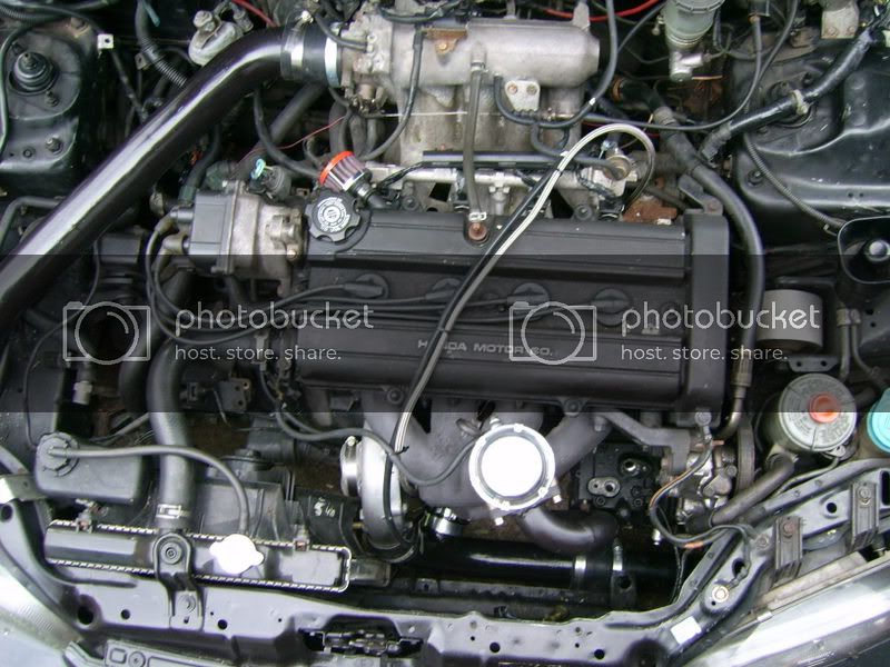

    A couple more pics.
    notice the Tial BOV, about 6" from turbo and the dsm injectors
    Also the FMU is gone. By the way its for sale. lol

    I would do something about the oil line over the valve cover. SS braided line works as a great low speed file... your valve cover will look like garbage if you leave that line rubbing on it...
    just a heads up. the build looks great! what a sleeper!
    Oh, and why is the a/c compressor still bolted on?

    i wanted to keep the ac, but after buying this other gsr motor, i decided to get rid of it...
    Im taking it off today.:D
    as for the ss braided line. well, it does look a little fucked up. Imma try to hide it.
    I'll work on that today.
    More pics coming tonight. ;)

    I meant it will mess up you valve cover, but yeah, it also is kindof an eyesore.
