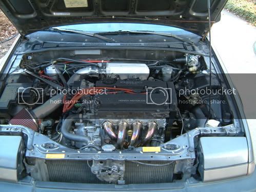

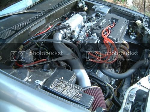

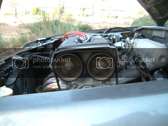

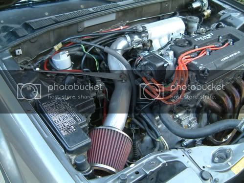

holy huge intake brace batman!!!!!! I would put a timing cover on that bitch, otherwise than that lookin good :thumbsup:
Quoted post[/post]]

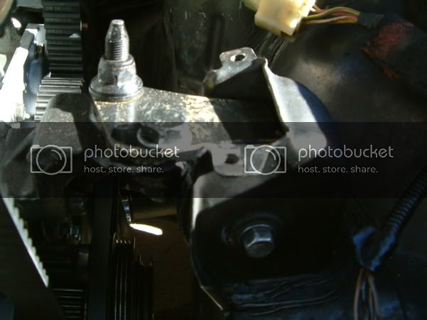

yeah it's a little big, but it's the only place I could put it without drilling. As for the cover I just need to quit being lazy ass and just put the cover on it. Thanks for the props and heres a little picture of the tranny mount.

lets see all the mounts pics please
This is the drivers side
This is the rear tranny mount kinda hard to see, but you get the jist. In this picture the mount need to be fliped the other way, I was just test fitting to see how it all works. I used the factory 90-93 integra rear mounting bracket. The brake lines on the firewall had to be moved up.
