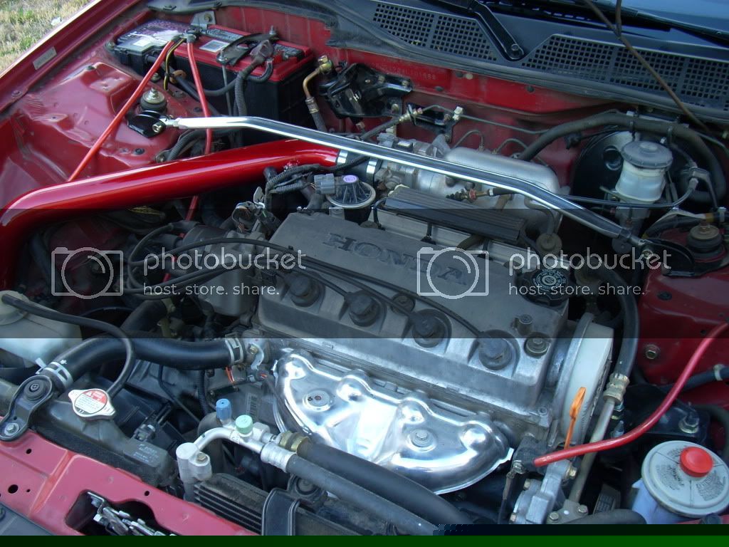

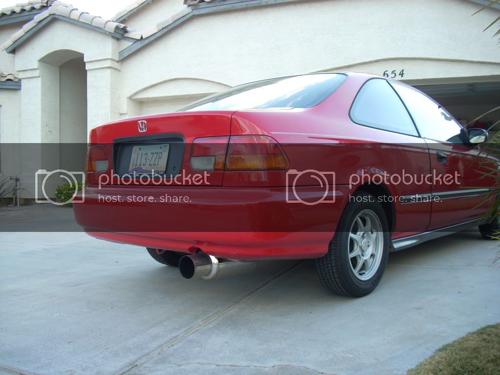

    Figured I would post up my build process of my 98 Civic Hx EJ7. I have had this car for 3-4 years now, picked it up from a good friend for $1000 cash bone stock with some minor body damage. He hit a cow and trashed the hood passenger head light, fender, door and mirror. It was well taken care of but needed some TLC. I replaced the hood with an unpainted primer hood, JDM style smoked head lights and a new side mirror, stil rocking the faded hood and dented door and fender, yea. As I said bought it bone stock but quickly added an AEM CAI to the D16Y5 Vtec E motor and started researching turbos for the single cam. An axle back followed shortly after.

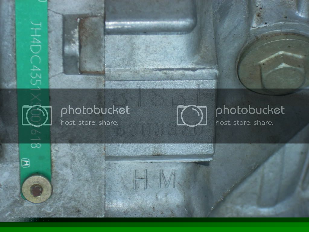

    After doning a bunch of research on the Y5 motor and finding it was useless are a tuner motor I got this for $800 long block with 60K axles, trans, harness and ECU
    After I did the swap, fully OBD2 functional and legal swap with no issues. Used a 98 Civic Dx harness the Hx harness was a pain to rewire and a OBD2 P75 ECU.

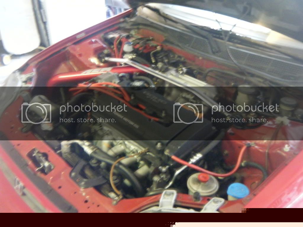

    That kept me happy for a while but I had always wanted to have a DOHC Vtec motor having built many in the past for customers it got me wanting one for years.
    So this started to happen
    [​IMG] B16 head fully rebuilt with all OE parts and 3 angel valve job.
    H22 Type S LMA with custom shims went it
    Hey what happened to my head?!
    and a day later
    Then it was back to the dyno to get retuned for Vtec
    Tim at SRD doing the magic tune
    [​IMG][​IMG]
    And the results are in
    Here is what she looks like today, now lowered on Eibach and GR2.

    ^^ where are you getting 25hp? Tuning the Ls gained 15whp plus whatever the IHE added before the first baseline run. 132whp is around 160hp not bad at all for a stock B18B1. If you want to look at it this was 117whp on my LS and 161whp on LS Vtec that is a 44whp gain from a head swap and proper tuning.
