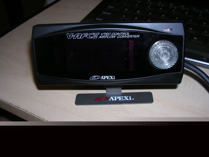

    Im also bidding on a vafc to lean out the fuel at idle for the cams plus it looks cool lol until i get it to tampa for the tune, dyno, street tune John offers.

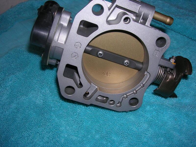

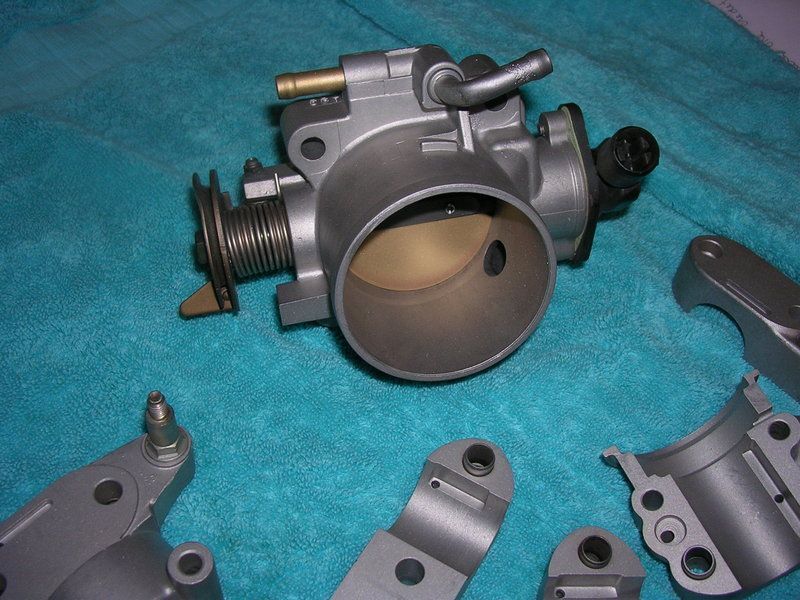

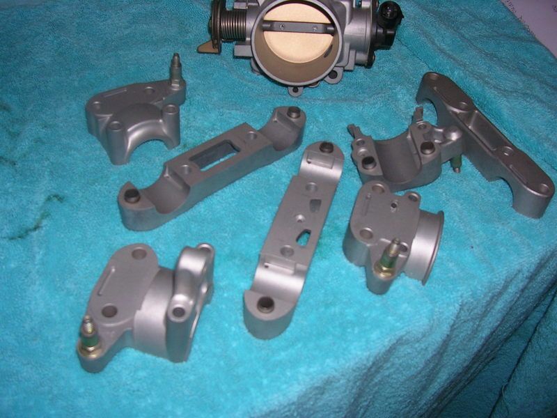

    ITR TB I got for $50 shipped not bad. 66 mm tapered to 62mm

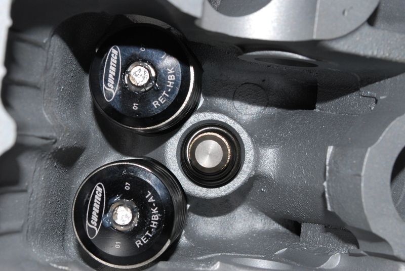

    Supertech aluminum retainers and specially degreed keepers....do not buy these!

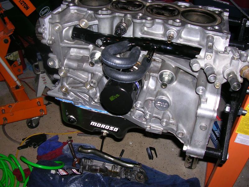

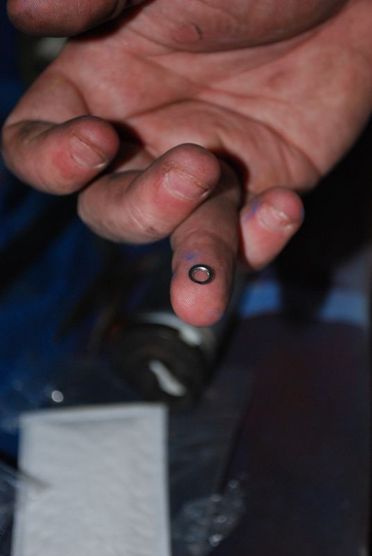

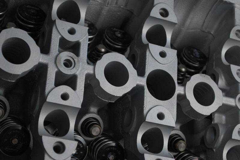

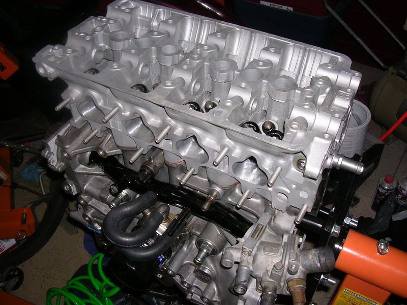

    street port from cw pence and valve job in orlando/maitland fl, good guys....you can see the bronze guides I went with
    KMS extended intake studs from king motor sports
    Supertech black nitride race vales for a lil bump in compression for my gsr head

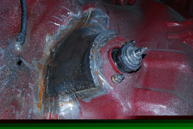

    So I didnt really take too many pics because my wife wouldn't shoot for me and she has the nice camera but I got few off of me working on the block.

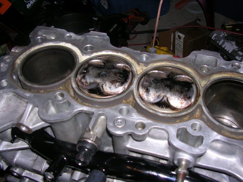

    I bought the block for $600 bucks from an old friend with usdm type r pistons that was supposedly rebuilt recently. Well the bearing farthest from the oil pump looked liked it had a little gauling on it so I was like fuk it for 60 bucks im going to replace them all. Turns out all bearings were perfect but that one but being anal I just replaced them all anyway with a clearance of .0015in which about perfect. Main bearings were cherry so i just coated the with some permatex asssembly lube{good shite about 6 bucks at advance auto}as well as all other bearings and moving parts will be coated with this as well as mobil 1 syn once its time for startup.

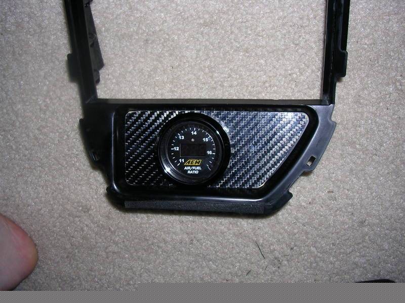

    I have the console so this will fit nicely where the ashtray goes and lighter since i dont smoke.

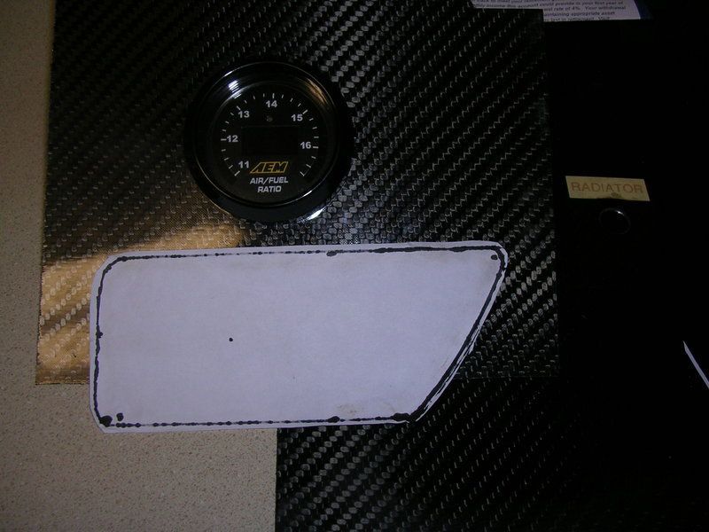

    AEM wideband, as you can see I have made a rough template to cut and then slightly sand down to spec to fit.
    I also have water and oil temp gauges fitted o the console

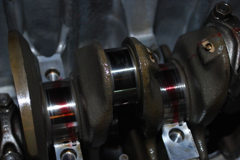

    Whos that douche oh yeah thats me popping the tang on the bearing.

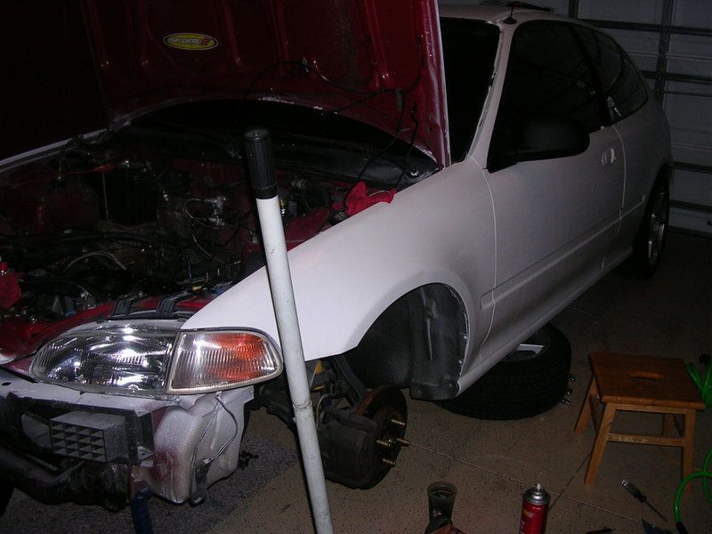

    oh yeah i painted my hatch white in my garage, came out ok, needs wetsanding and buffing and for me to do the engine bay and door jams, trunk area no biggie.

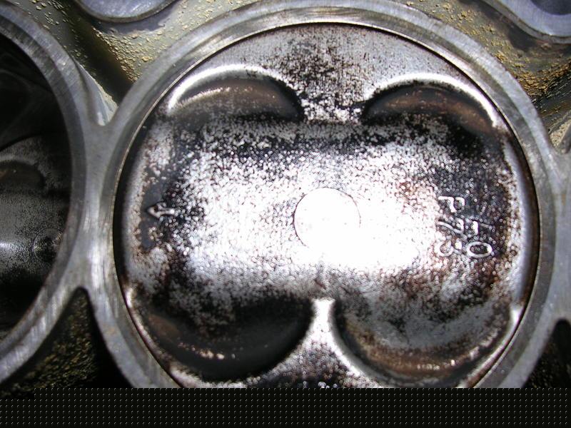

    Semi used usdm itr pistons, walls looked good so i didnt mess with them.
    corrosion sucks, dont just run water in hot states atleast run water wetter too to keep calcium off the cylinder walls.

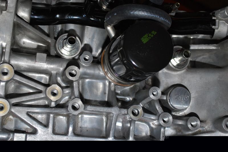

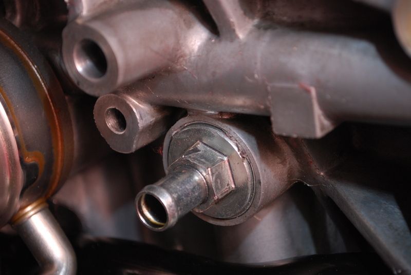

    As you can see here Ireplaced the water pipe and replaced all new hoses. you can alo notice the z10 plug and fittings for an endyn breather setup. I replaced the thermostat and also added the street morroso oilpan with built in oil baffle. for the money not a bad pick up.

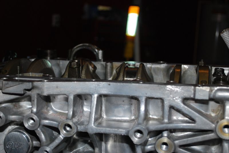

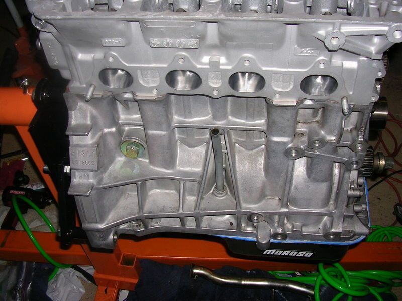

    Internal areas

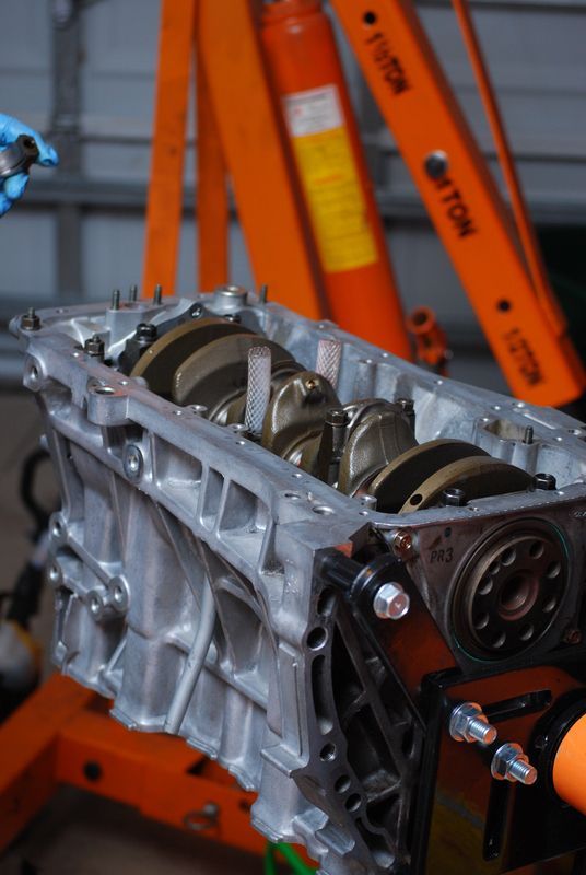

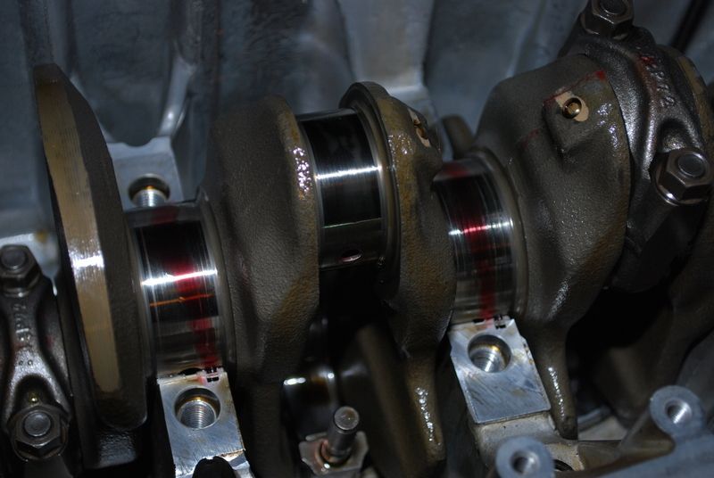

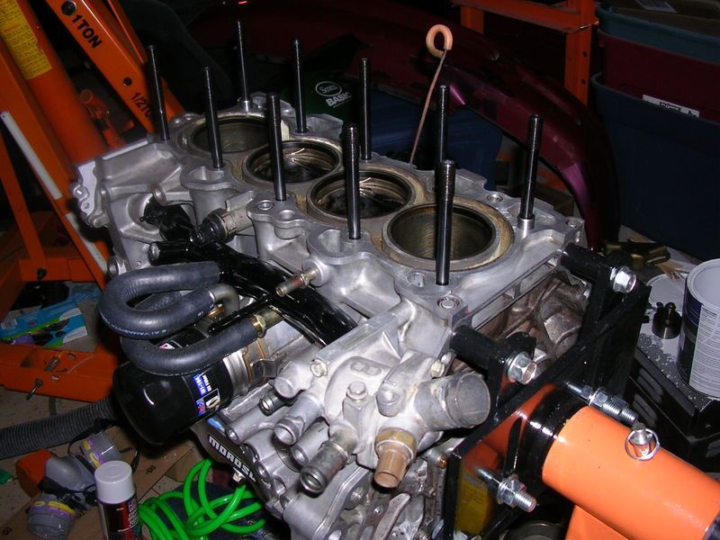

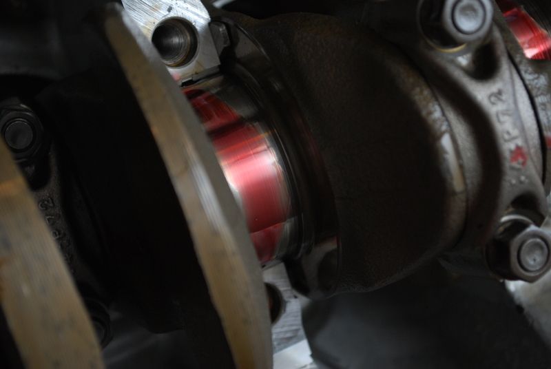

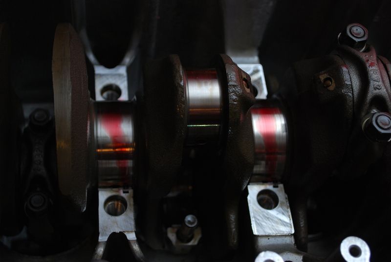

    You may be saying WTF are those hoses doing?? well when you replace the bearing without removing the piston there is a chance you could scratch the crank when pushing the rod down to get out the bearing so that is a cheap easy way to do it. Make sure when you push them down that you have your other hand holding that piston from the bottom so its doesnt fall out, that way you dont have to redo the rings.

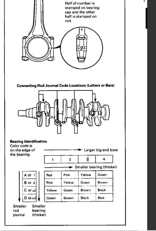

    Just to share how you go about picking bearings granted your crank is not sol!
    take the number {3 is highlighted because that was what mine were}from the rod and then correlate with the letters on the crank which are very simple to find. In my case it was brown, brown, brown, Green.

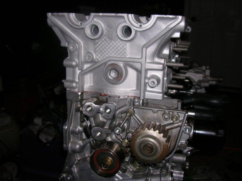

    here is a pic of the recently retired lsvtec, i will be selling the short block thats got the golden eagle kit on it with dowels and vtec oil and water pumps once this new build runs.

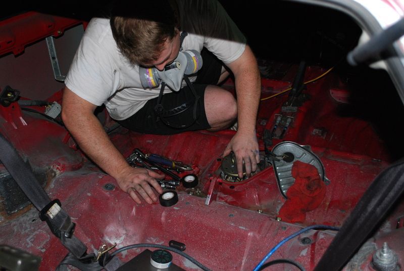

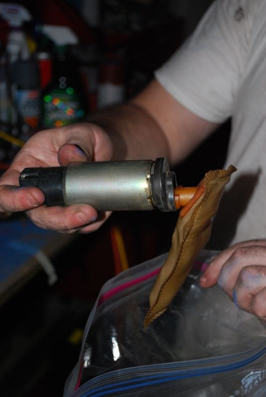

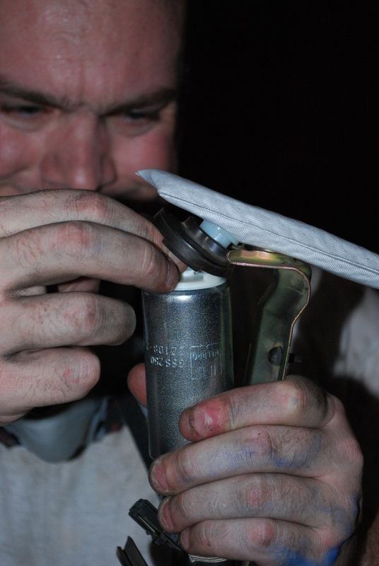

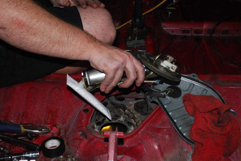

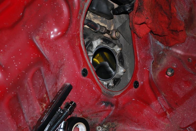

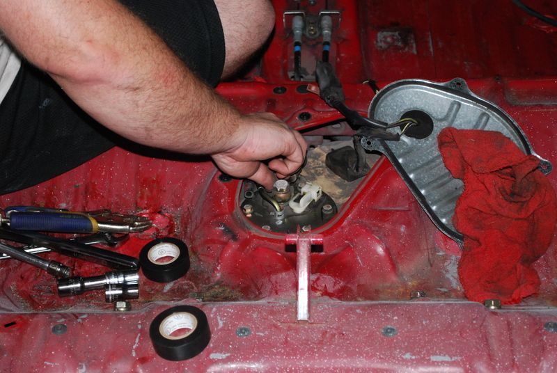

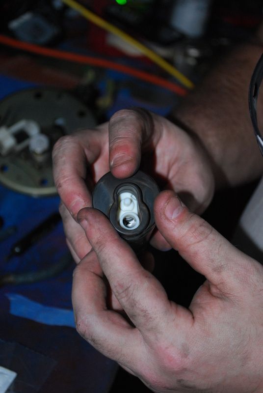

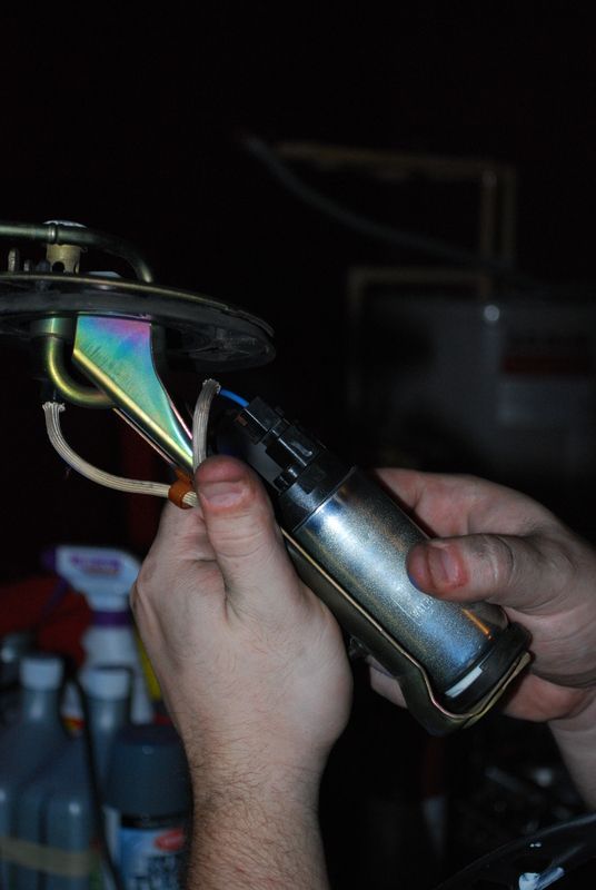

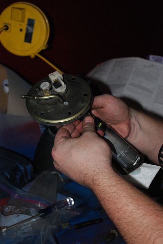

    Starting on fuel pump, this wasnt that hard just time consuming. I would wear a mask of some sort because the fuel fumes are not pleasant.
    Pulling it out
    Here it is out and off the rack it sits on. The black piece on the bottom you need to install on the new pump so care fully remove it.
    Here it is off
    Install on new pump
    Fuel tank waiting and begging for more pressure
    Lining it up

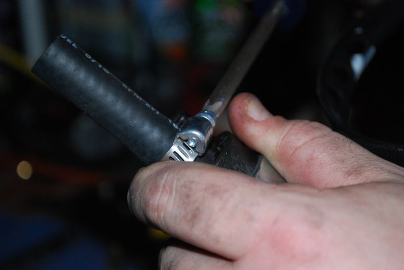

    You can see how small the gap is but cut your hose just a little bit shorter than the stock unit. The new hose is supplied with the kit.
    Comparing old smaller to new larger

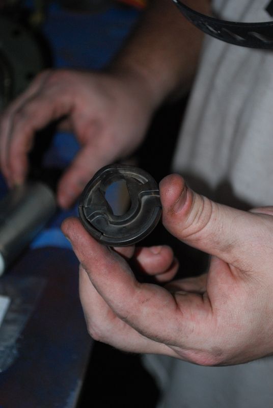

    This was a bitch, fit the retaining washer on the pump
    Installing fuel hose
    Pretty much done just buttoning everything up
    Going back home, go in from the side then rotate
    And thats that

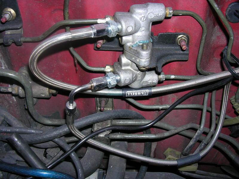

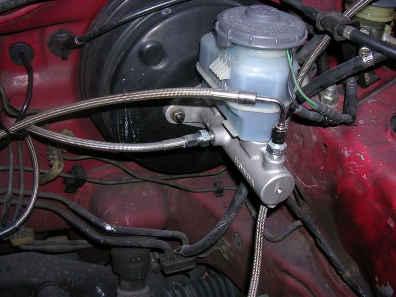

    ITR 1 inch MC and booster with russel lines and earls fittings.
    Super blue racing brake fluid, I already had the 40/40 prop for my 4 wheel disk but hadnt upgraded the mc and booster until recently. Wow what a difference! My tires cant keep up with the braking ability I have with the brembo blanks and hawk pads.

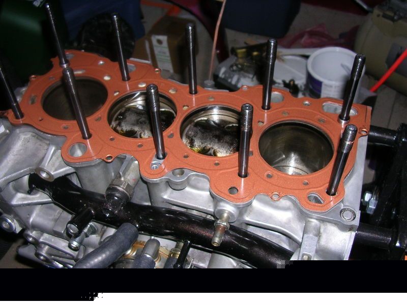

    My buddy dropped by and gave me a hand so I could drop the head on with no problems so it got done and Im that much closer now.
    ARP head studs installed
    Oem 3 layer gasket with copper spray sealant
    Head dropped on and washers and nuts hand tight on studs
    Torque sequence for those interested
    Done

    VAFC2 came in today...$140 shipped not bad...obviously used but looks new.
    Skunk2 pro 1 cams and pro gears will be here monday.
    parts left to aquire:
    rc 310's
    fpr
    fpr gauge
    maybe fuel rail
    tb gasket
    Just powering it up to make sure it works.
