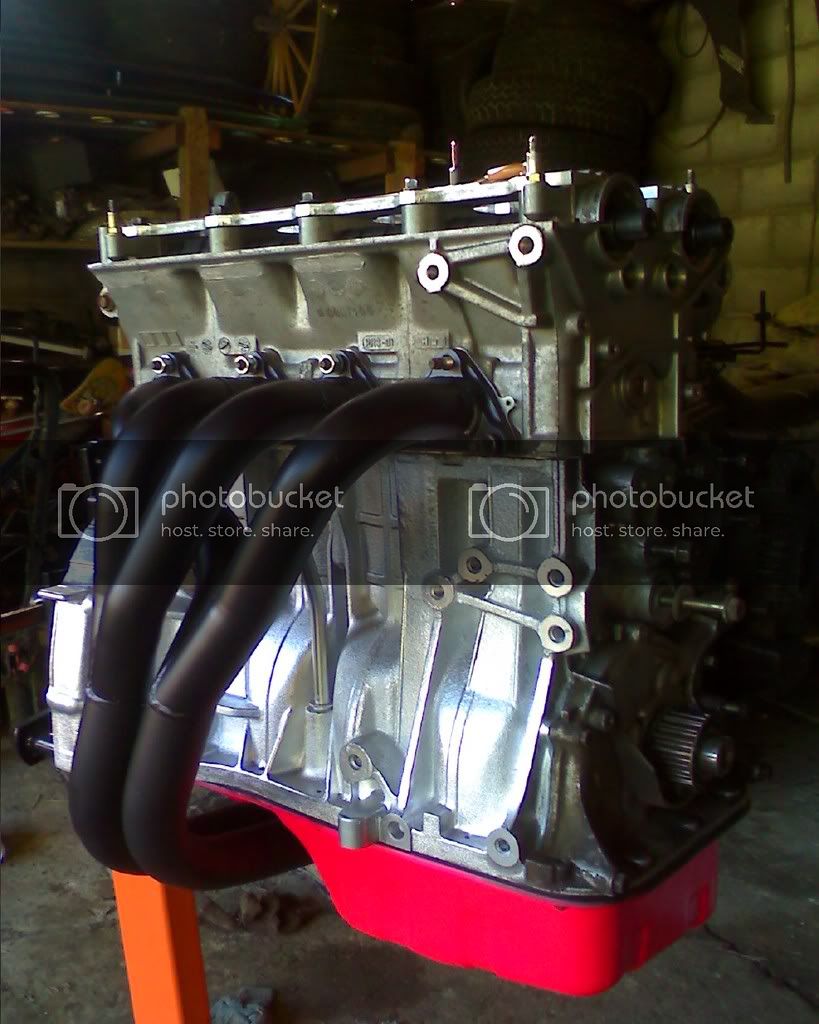

The motor now is ungodly tasty… It’s almost done just hanging out on an engine stand but this is what it consists of as it sits right now…
B18A1 bottom end bored to 81.5mm
Wiseco 9.5:1 Pistons
Eagle H Beam Rods
Polished Crank
ACL Bearings
ARP Rod Bolts
DIY Block Filler
ITR Head (hot tanked and fresh as hell)
JDM ITR cams
Skunk 2 Intake Manifold
ACL Complete Gasket Kit
Fidanza Flywheel
DC Sports 1 Piece Headers
LS Vtec Kit
Cold Fusion Dry Nitrous Kit (Going to run 150 shot)
Power Steering and AC Delete

build look great. my car handled a 150 shot on the last build decently. previous owner loved nitrous. now the motor is fully built. how in the hell did you get the block so clean. im jealous. and invest in a block gaurd and weld it in.

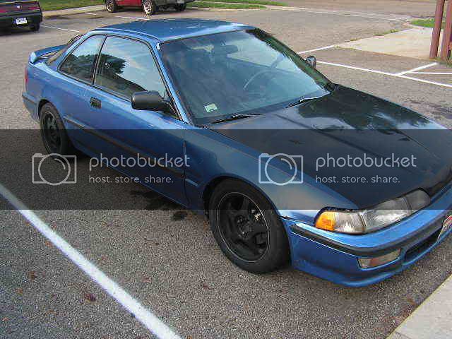

I think it's about $3.50/ can for spray paint. :D
Maybe it's the camera you used but it looks like you rattle canned it, get some better pics so we can get a better idea of what it looks like.
no it was about 37$ for a quart of primer and a gallon of reducer actually
and the camera was my phone
good, it must be you're phone then, unless above the rear wheel is overspray. I know there's sunlight hitting it but it still looks like overspray.
