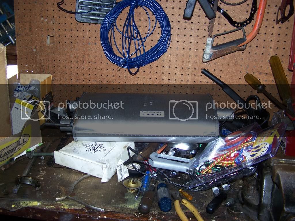

    He just bought a Civic Si style muffler w/twin tips.

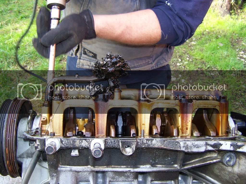

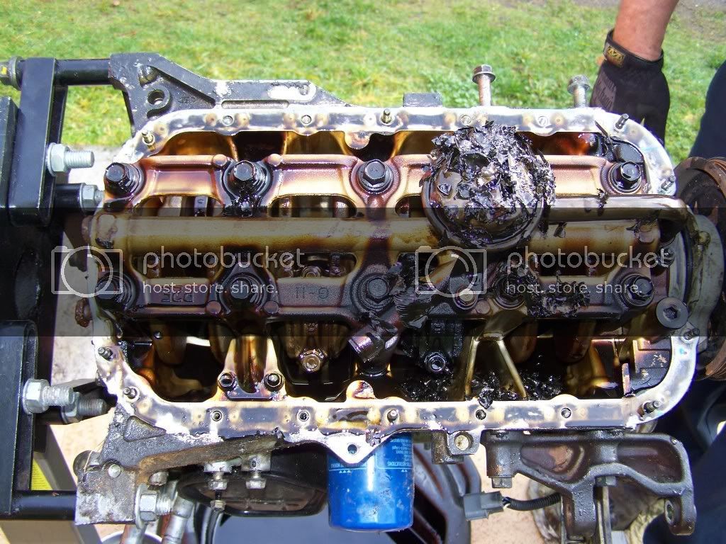

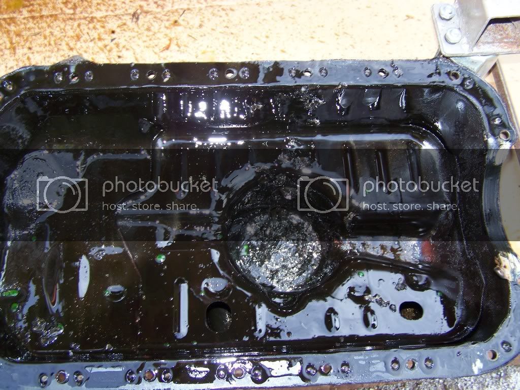

    Carnage...spun and destroyed two bearings. :eek: When we took it apart it was connecting rod against crank, no bearings inbetween. :eek::eek:

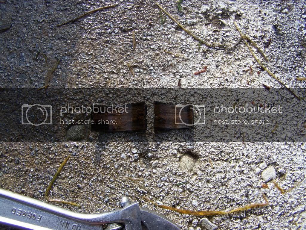

    Connecting rods were overheated, tempering was lost and they cracked, ready to break.

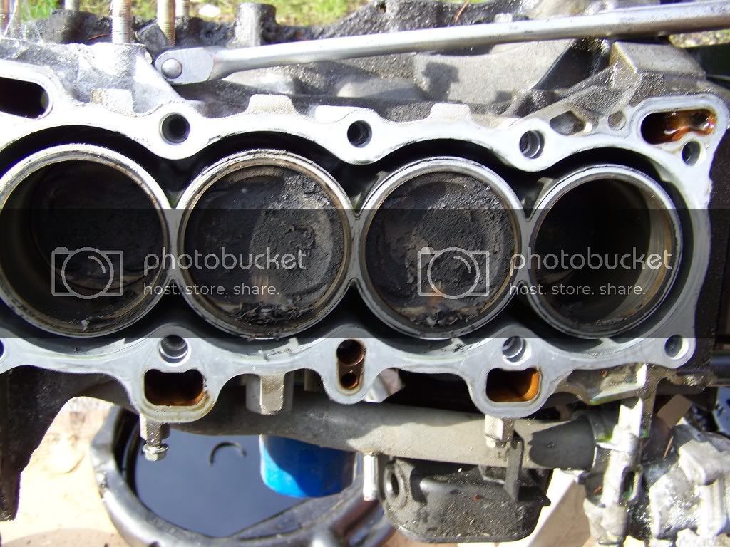

    Ass ton of carbon but very clean walls.

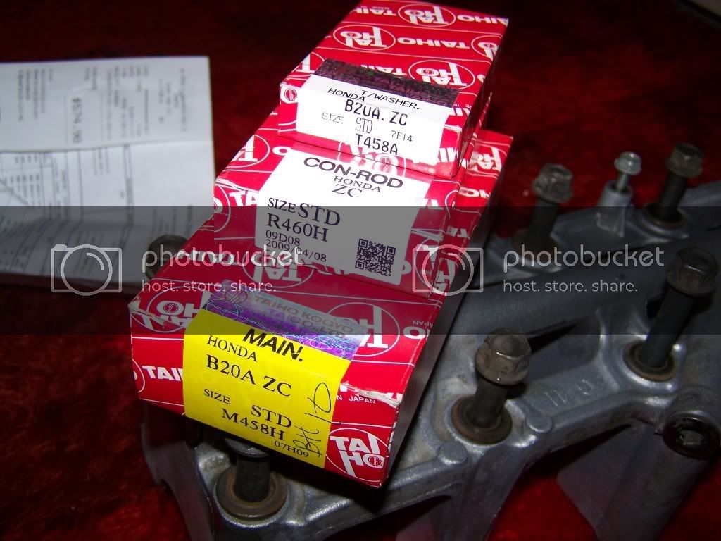

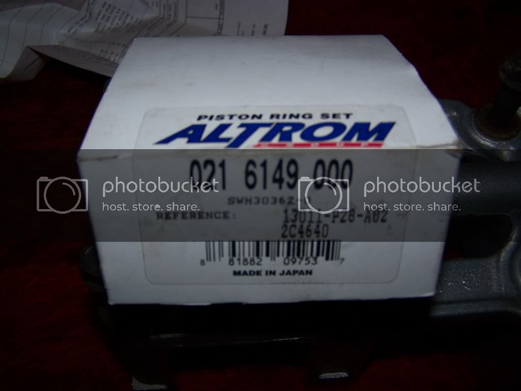

    Head is very, very clean and we're rebuilding the Y7 block with new bearings, rings, oil pump with D16A6 con-rods and crank. Re-useing the headgasket, water pump and timing belt, all are in super great shape. D16A6 intake and exhaust manifolds are going to be used with a Si dizzy and PM6 ECU.

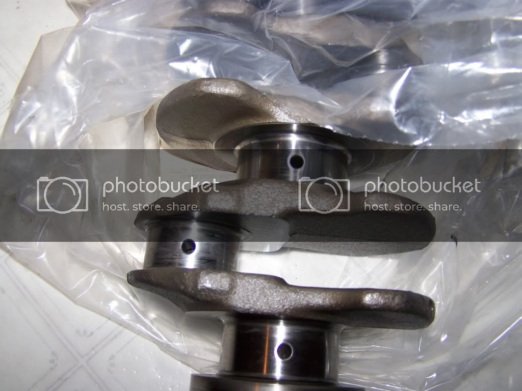

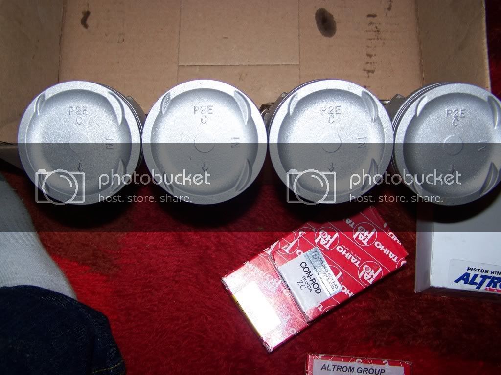

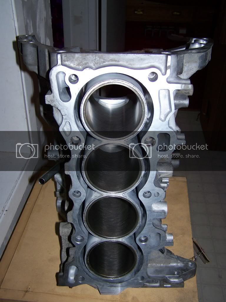

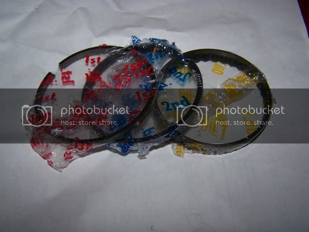

    Block is done and parts are arriving on the 16th. Block is cleaned and honed. D16A6 crank is cleaned and polished. And the D16Y7 pistons have been pressed onto the D16A6 rods.
    Next we'll bore out a oil pump as much as we can then assembal. :)

    Block is back. $575 after labour and parts.
    Drilled/installed for dipstick.
    Polished A6 crank (Its just oil on the journals, they shine like a mirror)
    Y7 pistons pressed onto A6 rods and cleaned.

    We went with the Y7 block so we wouldn't have to bore out the scratched A6 block and buy bigger pistons.
    The Y7 block it self is the same as any other D16 block. Where the differences are is in the crank and oil pump. If you look at them its simply retarded. Honda had a good thing going, why mess with that? Anyway we put a A6 crank and oil pump in.

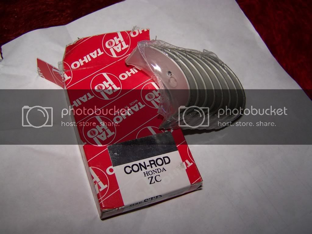

    I gotz mad Jay Dee Emm internals yo. ZC spek to be exackt!

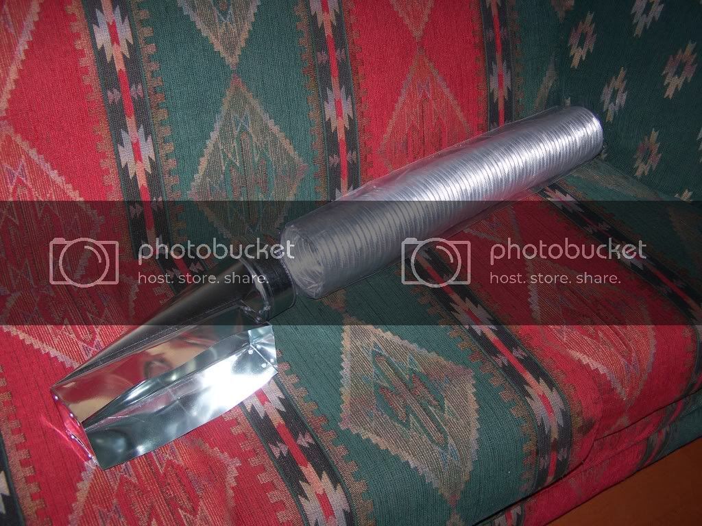

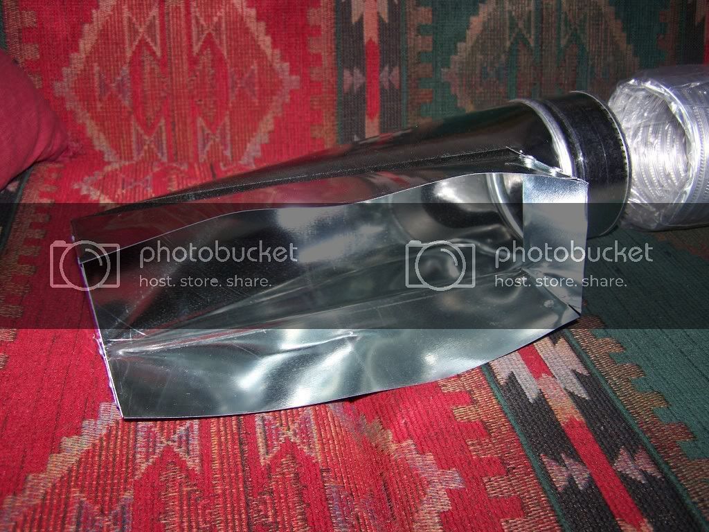

    We still haven't got started on the ass'y. Were lazy. :)
    Got the intake parts though. Now I just have to pull the headlight and were set to go!

    WTF? JDM InTake Y0!?
