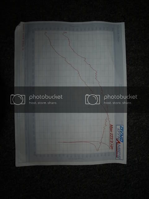

    well this is the dyno sheet from my bone stock d16y7 on 9-10psi on a big16g knock off china turbo. Im tired off all the haters trying to call me out on post and PMs and say that my motor dosent make that much power and yada yada yada
    my setup
    D16Y7
    ebay turbo kit with Tial wastecate (big16g knock off)
    36#h ford motorsport injectors runing at 70psi base because they were to small
    D16z6 intake manifold
    2 1/4 down pipe
    2 1/2 exhaust with a flowmaster 50 series
    Tuned with AEM (11.0-11.2 AFR across the board under heavy load) not telling any thing about timing thats where power comes from
    skunk 2 cam gear advanced 2deg
    final numbers were
    224hp @6200
    209tq @5100

    Im not even gona start a list of them not worth the drama. I just wanted to start a post so i can refer them to it next time they mouth off about how a d16y7 cant make that much power and it will blow up. I have bad news for them also. I ran it on a dyno jet durring a dyno day at a local shop and those numbers were quite a bit higher 247hp and 229tq but i think they were a little off and i didnt want to give the guy $50 for a piece of paper.

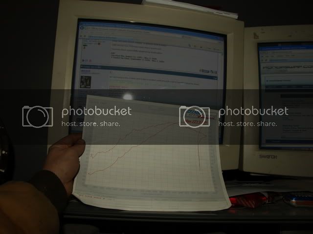

    im not trying to be a hater,and i believe you,but could you post a pic of yourslf holding the sheet,

    the engine has been boosted for about 1.5 years and autocrossed often and on the road corse once
    and just for you INJEN

    just for the record, 227 hp is not "a lot of power" :)
    still, good figures for a y7. screw the haters
