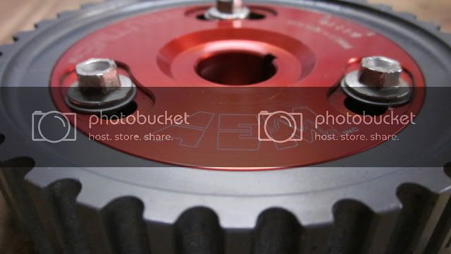

Here's what came in the mail today from Diller (member of DSO). This thing is barely used and the filter is like new:
And he tossed in a Vstack for little to nothing, so I figured why not.

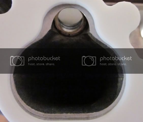

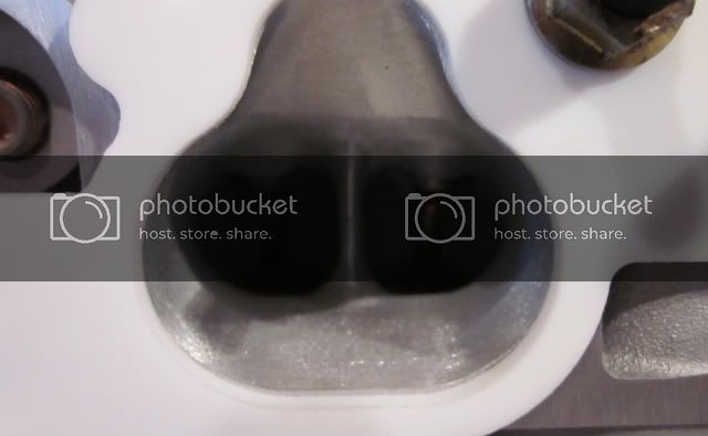

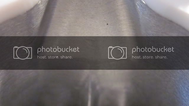

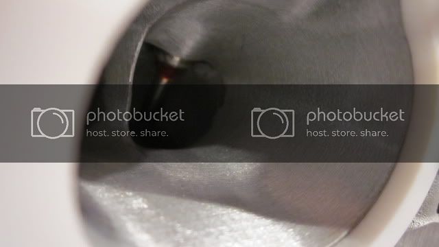

I had somebody on another forum ask if I planned to "gasket match" the Hondata gasket, I said no and this is why:
Roof
right side
left side
Pretty flush where it counts

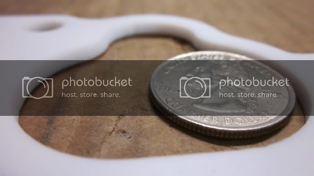

then I held it on the intake mani
Looks good enough to me
