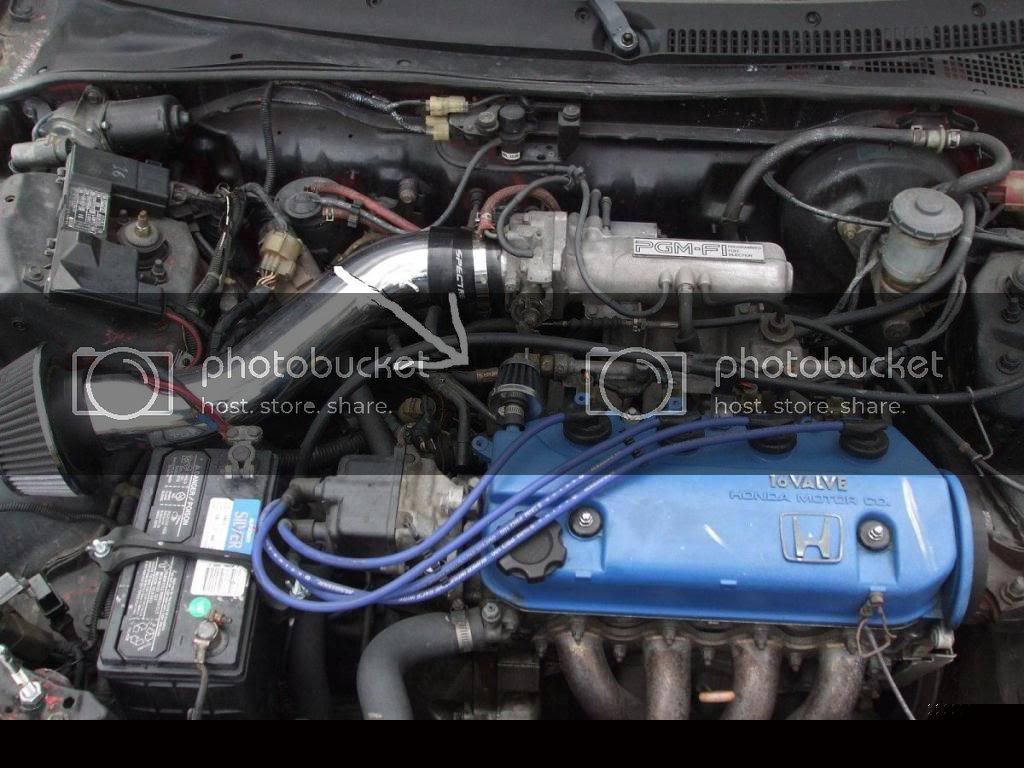

    I would definitely check that ground first though. I pulled a big stupid not too long ago fxing my car. Instead of actually doing a full thorough check ofall my grounds and everything, I just started throwing money at it. I totally regret it now. I spent upwards of $1500 in new parts, and one trip for a diagnosis (which didn't help either). The whole time it was that thermostat ground. My symptoms were sputtering and a kind of bucking under load (giving it power).
    To find it, go in between your distributor and your intake manifold, look down and look for a hose going out. It should be pretty close to that hose, underneath and a little to the right. I don't believe you can see it from the top, at least I couldn't see mine.
    Here's a pic for the general area. Your going to have to really get in there and look below things, reach your hand down there and see if anything is loose.
