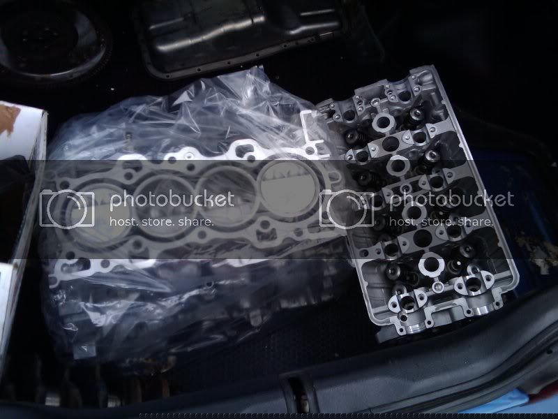

    The B18A1 and B16A head back from the shop:

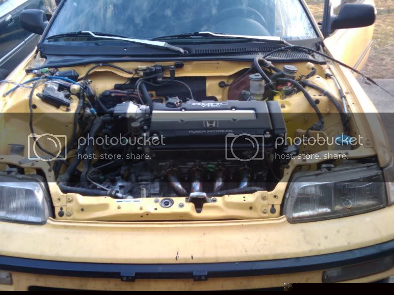

    Engine installed. You can see where the clutch fluid reservoir was mounted by the brake fluid reservoir.

    Decided to start completely fresh, and ordered the B18C5 head and B18B block. Also purchased some new Wiseco rings, some new bearings since the ones I had were scarred by the coolant, a new headgasket, new intake manifold gasket, a catch can, and an OEM N1 crank pulley.
