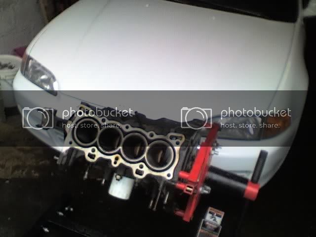

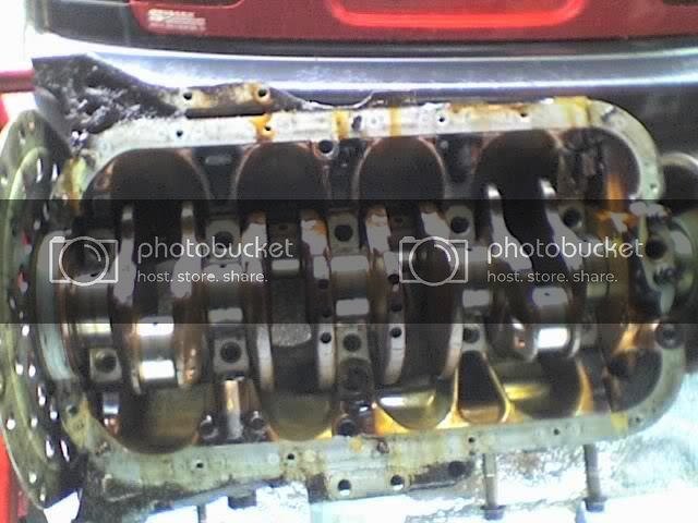

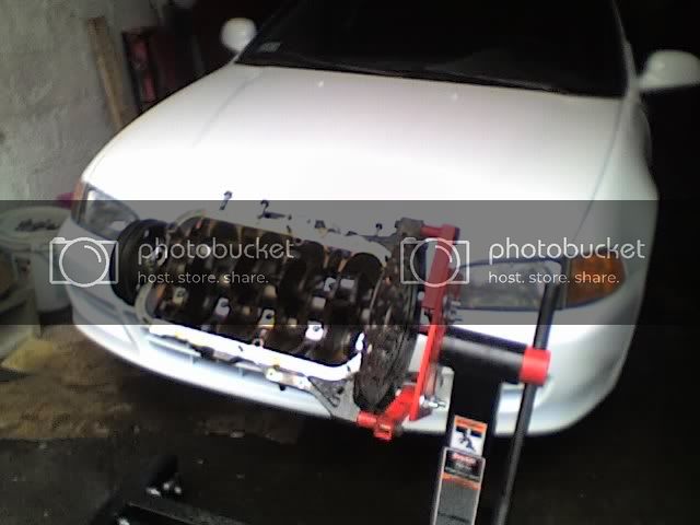

The Z6 block is now 100% bare. I'll drop it with head tomorrow morning to the machine shop. They said that i'll get them back sometime next week. I have some questions.
1-Shouldn't i get the internal and send to them with the block to make sure that size ,clearance... are respected?
2- My goal is 225-250 hp. I'll be getting the CIVIC EX/SI greddy turbo kit TD04H-15G 8cm2 w/e-manage. I know that there're better setup with more potential. But honestly i like this one because it's bolt on and even with all the reading i've done on turbo i don't want to go over more complicated situations.
3- I wanted with Blanco advice to go with CP pistons and TT rods but just wanted to know what you think about this: eBay Motors: D16 Civic CRX Si Turbo Engine Kit Pistons Rods Gasket (item 180106570398 end time Apr-19-07 13:51:41 PDT) ? They only have 8:5:1 comp ratio and I want to keep the stock comp ratio (9:5:1) or go 9:0:1 but i can't find any forged piston with those comp ratio.
4- Is 9:5:1 or 9:0:1 a good idea?
5- Where can i get those pistons?
Thanks! Sorry for the long posting!

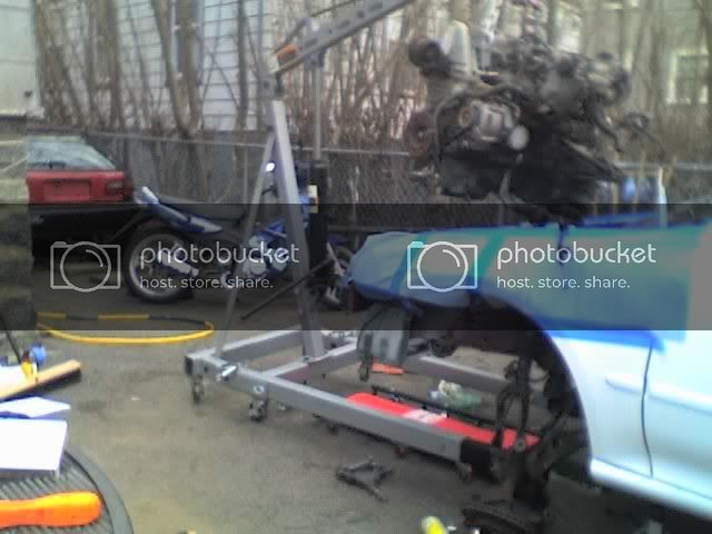

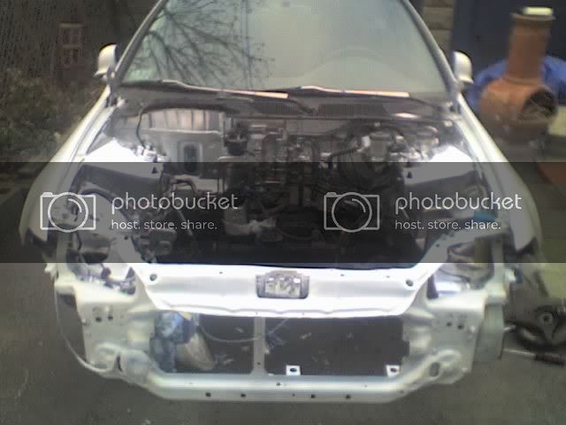

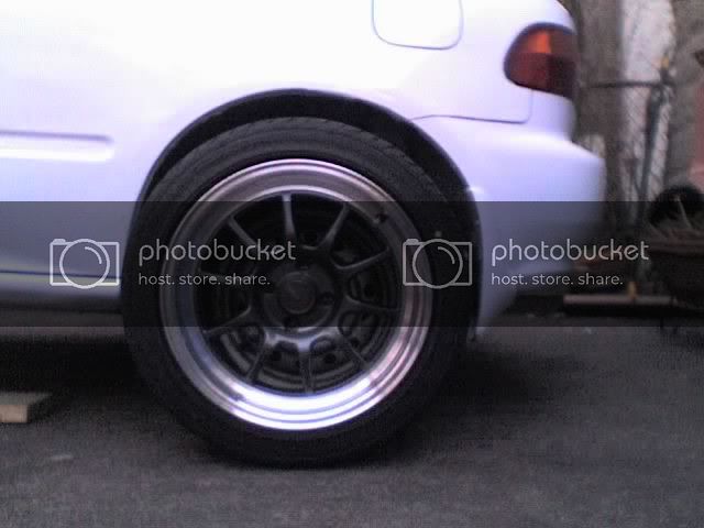

I've decided to take the d15b from the del sol and put it in the eh23 project. While i'll be waiting for the build my focus will be on suspension parts and tire / wheels.
I need to buy a new clucth + pressure plate and flywheel . Wanted to know which one should i go with (there is so much). Any suggestions (brand stage weight) will be great. Thanks!

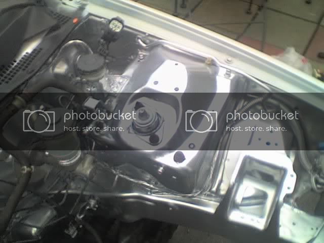

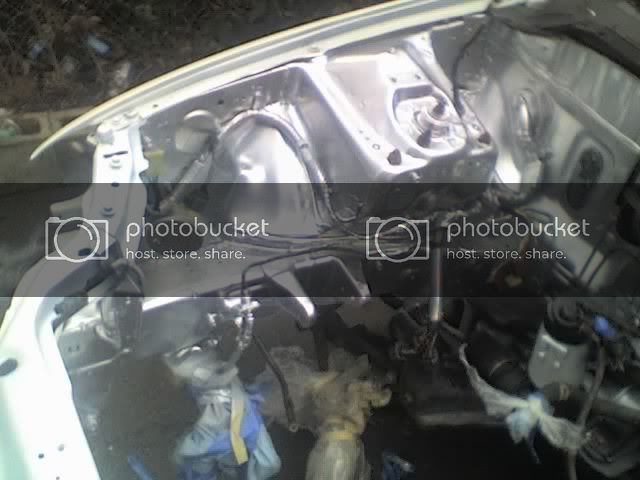

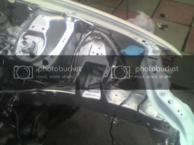

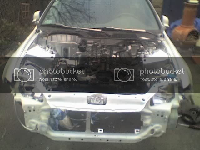

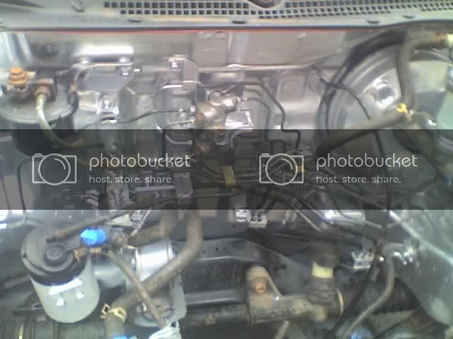

update

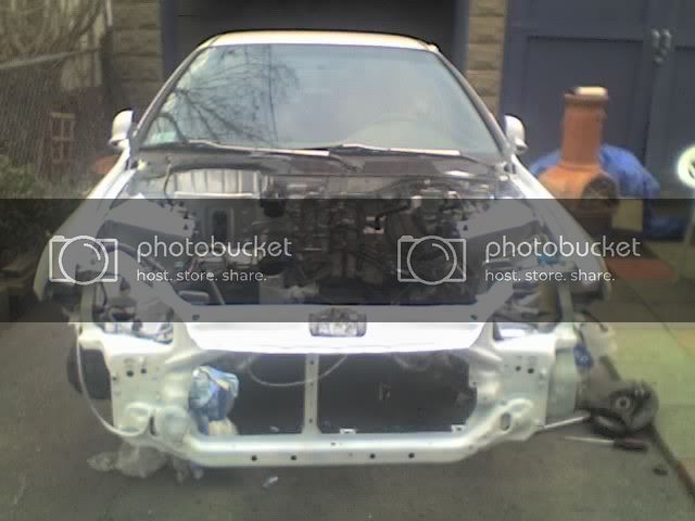

Engine bay painted.
