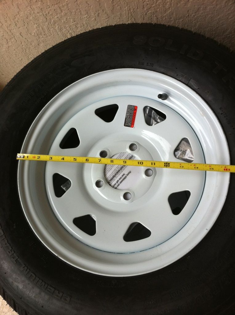

I got some new trailer wheels and tires since mine were mismatched and had mismatched sizes.
Not that exciting I know. I didnt want to drive all the way to Roebling on the old ones.
So I replaced the trailer hubs too and it rode pretty well to Savannah for the Roebling Road Raceway event I did this weekend. Wikedeye dropped by Sunday and it was nice to meet him, he also got to ride in a pretty quick Spec Miata.

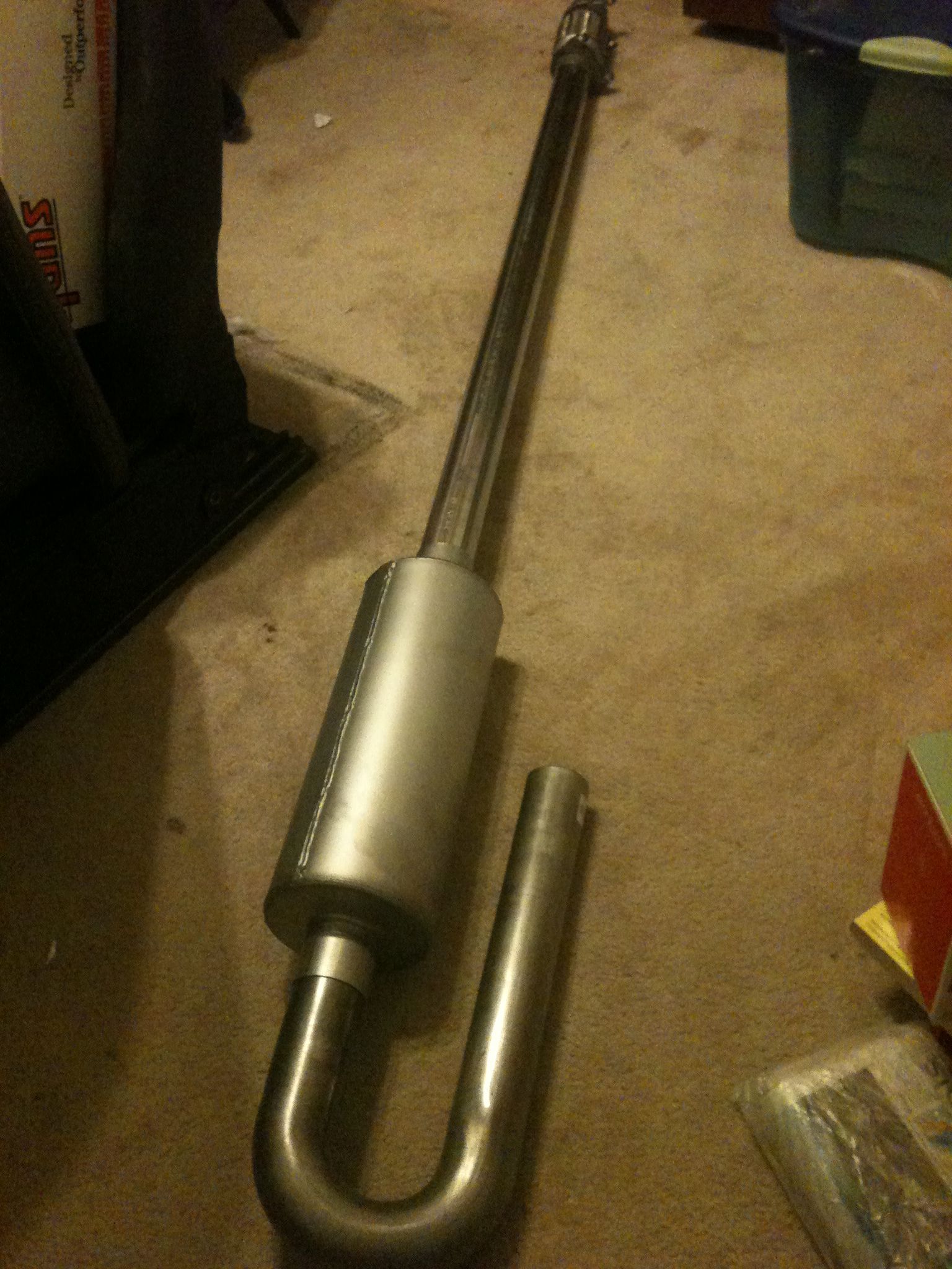

I want to change my exhaust, anyone have any experience with burns stainless mufflers?
Im looking at doing an actual race exhaust exiting down right after the driver seat.
bisi had a full exhaust system for a turbo though...I was curious to see if anyone had input on length for optimal performance while dumping it right after the driver?
I priced out a system for a race exhaust of about 3-4 feet for around $400 with all high quality ss and the burns muffler and hardware. I think I might grab it all and TIG it myself which will be fun I think.

I think after researching I might just go with a magnaflow bullet style muffler and save some money and issues.
Magnaflow ftw. A good friend installs them on all the race trucks he builds. You have a TIG welder?
I went with magnaflow and just crush bent 3" piping. I suggest you do the same. Do any of your tracks have sound levels? Ours do so I did a 22" long 3" resonator and then a 3" chambered muffler.
I think the burns stuff is expensive and un-necssary unless you're building a spec motor and need every last ounce of HP. In which case you'd also want a $1,500 custom header to match it. :p
The tracks all have sound limits, I went with a 16 inch and 2.5 inch tubing. I think my Hytech copy header will be good enough for now.
I will be dropping it right behind me so hopefully its not too loud or I can add a resonator.

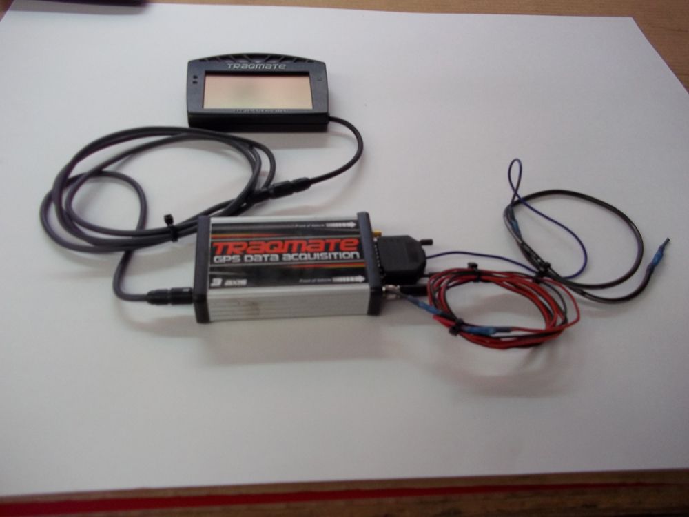

TraqDash Traqmate is on the way too, found a used one that has been used for like 3 events in a real race car professionally built. So its in perfect shape for a pretty big discount that should help me with data and improving my driving.

Exhaust came, I didnt realize it would all be slip fit so thats going to make welding it easier since Im a noob welder.
The muffler circumference is bigger than I was thinking for some reason so Im hopefull it fits it the tunnel under the car somewhere!
Dynomax, ultraflow welded 409 ss if anyone is curious.
The J bend obviously is not staying like that and will be cut to make a dump off the back of the exhaust.

Traqdash Traqmate should be here soon.
Are you going to keep yours?
I went and picked it up today...pretty simple and small, the gps antenna isnt pictured but thats everything.
Not bad for almost half off!
I figured I would add this because it will be helping with my progress of finishing.

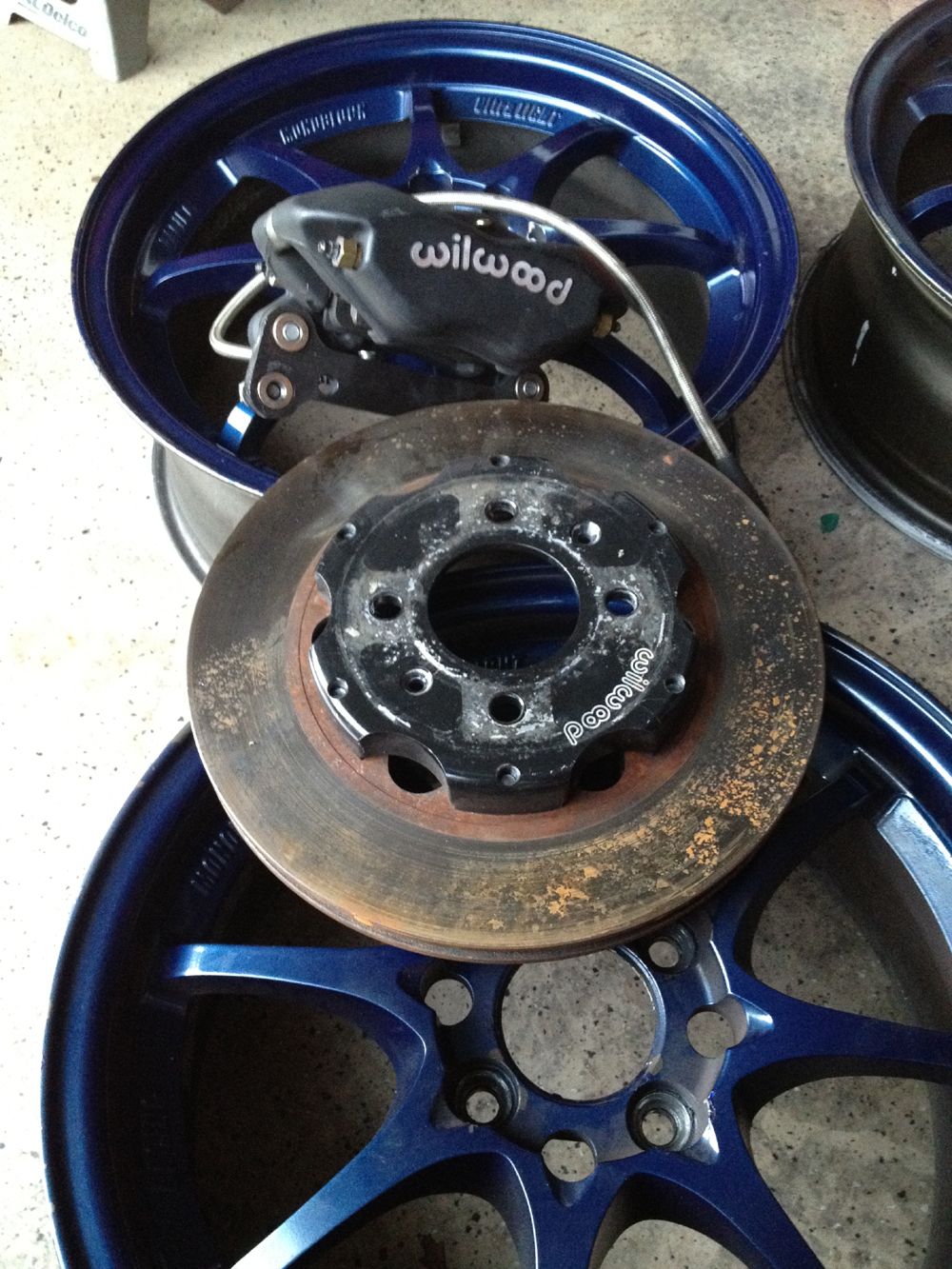

traded/sold
Im just selling because these will not fit over the brakes I want...9.5lbs a rim!
So I traded the rpf1s and conti tires for a set of konig heliums, almost new 2 piece 11in rotors and 4 piston wilwoods straight up.
I didnt think I could get a better deal and I was selling the rpf1s because I wanted wilwoods anyway and they wouldnt clear the rpf1s.
I still have the kosei k1s and now the heliums which I will throw another set of r888s on when they come in from the recent sale they started on them again. So I will have 2 sets of r888s for school and my first races in the new year.
