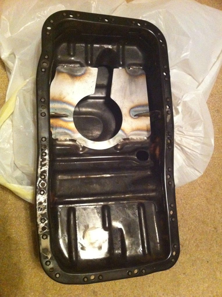

I got busy and havent been able to work on the car much. I did get some things done today and I will have some more pics tomorrow but here is the baffle kit installed.
Nice! Let me know how that works for you on hard left handers. Before my Moroso pan I would lose oil pressure. I had just a stock pan; no baffles then. Was curious how well those weld in ones worked out.

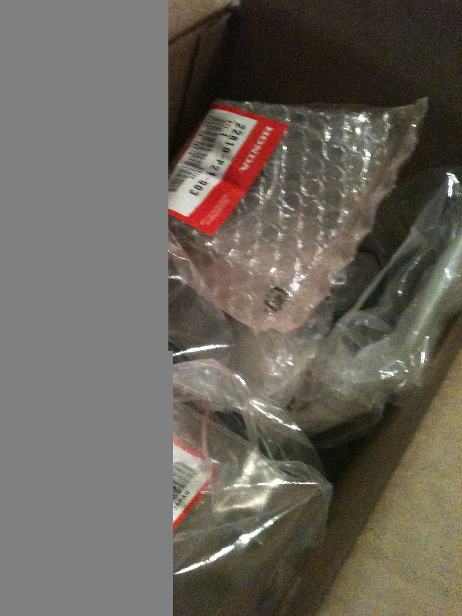

oem gasket kit for the valve cover, oem throw out bearing, oem thermostat, oem alternator bolts. I was surprised how fast it got here! I will have no excuses not to get work done tomorrow.
