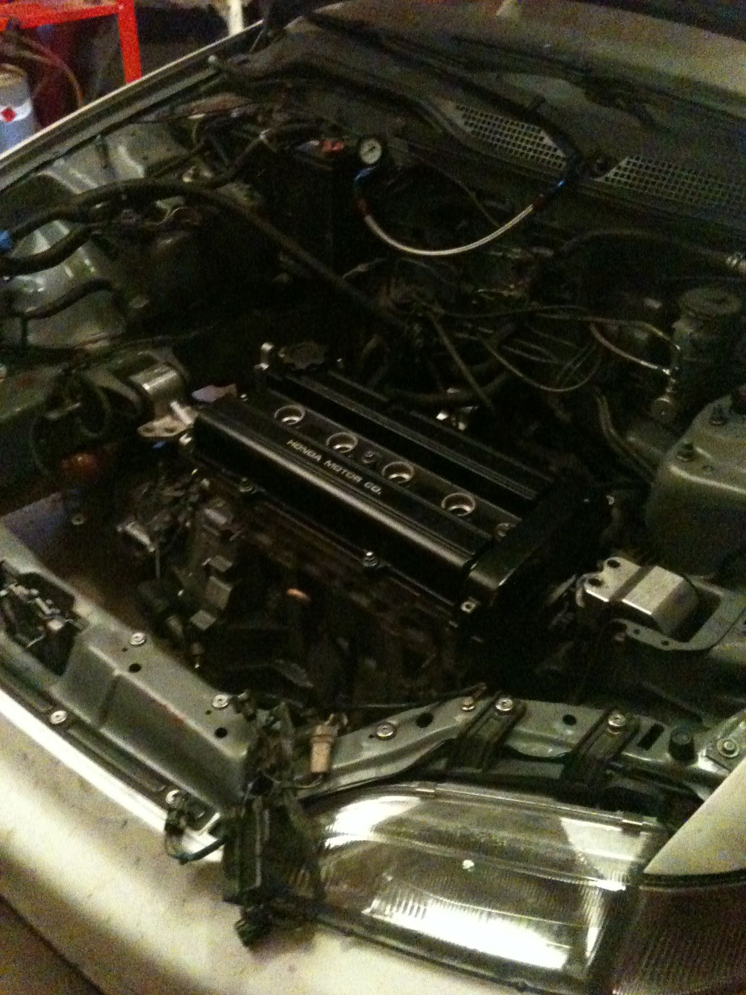

My newest build for SCCA STL/HPDE's
Courtesy of Dave Gran www.goaheadtakethewheel.com
I will be using this diagram but obviously execution is another thing which I will get to at some point.
Not a huge update but every bit gets me closer. I really want to make the June NASA Sebring event but I dont know if the cage will be done. The faster I get this in the car running, the faster I can get to the cage.

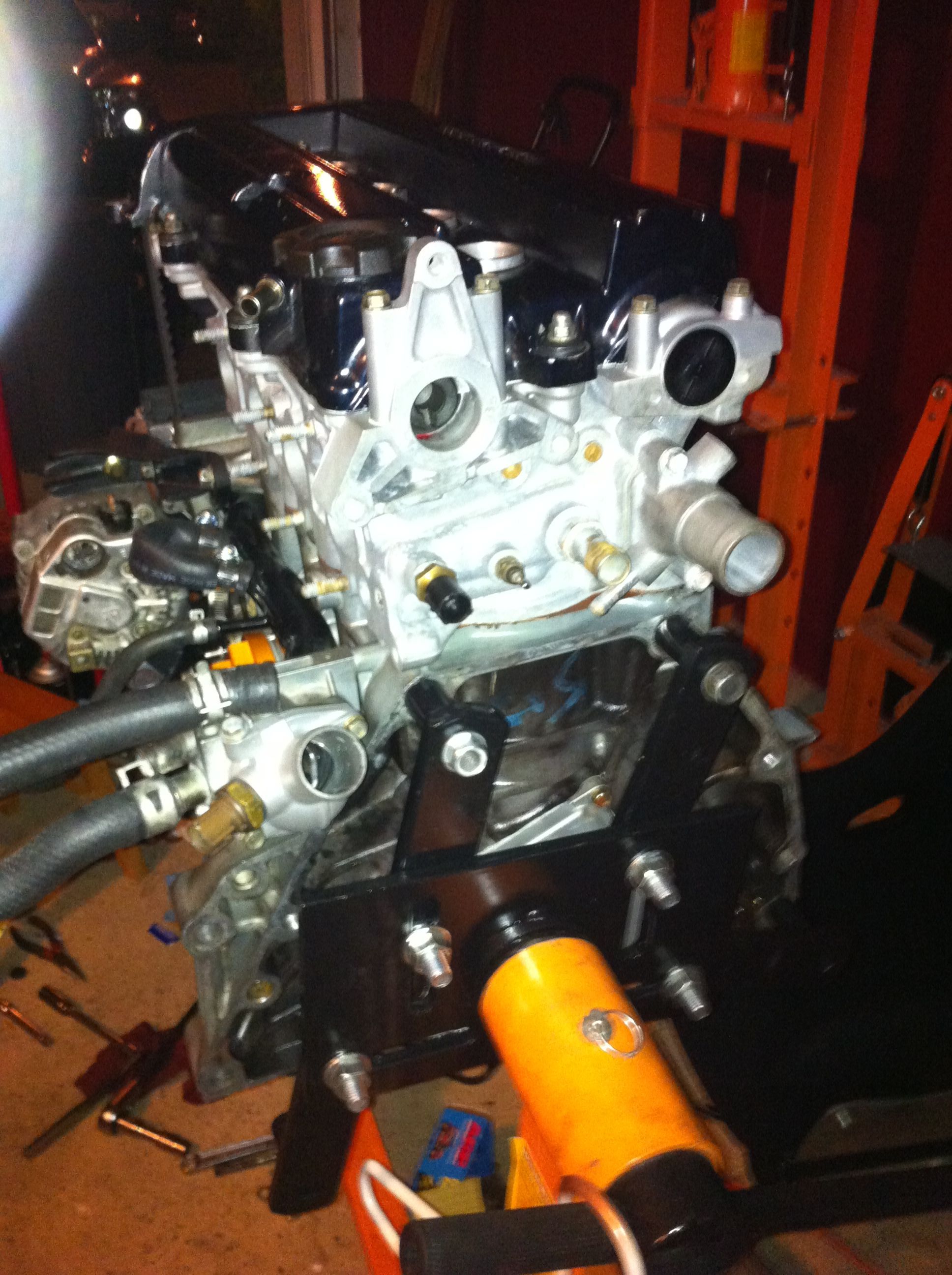

bead blasted the stock intake manifold

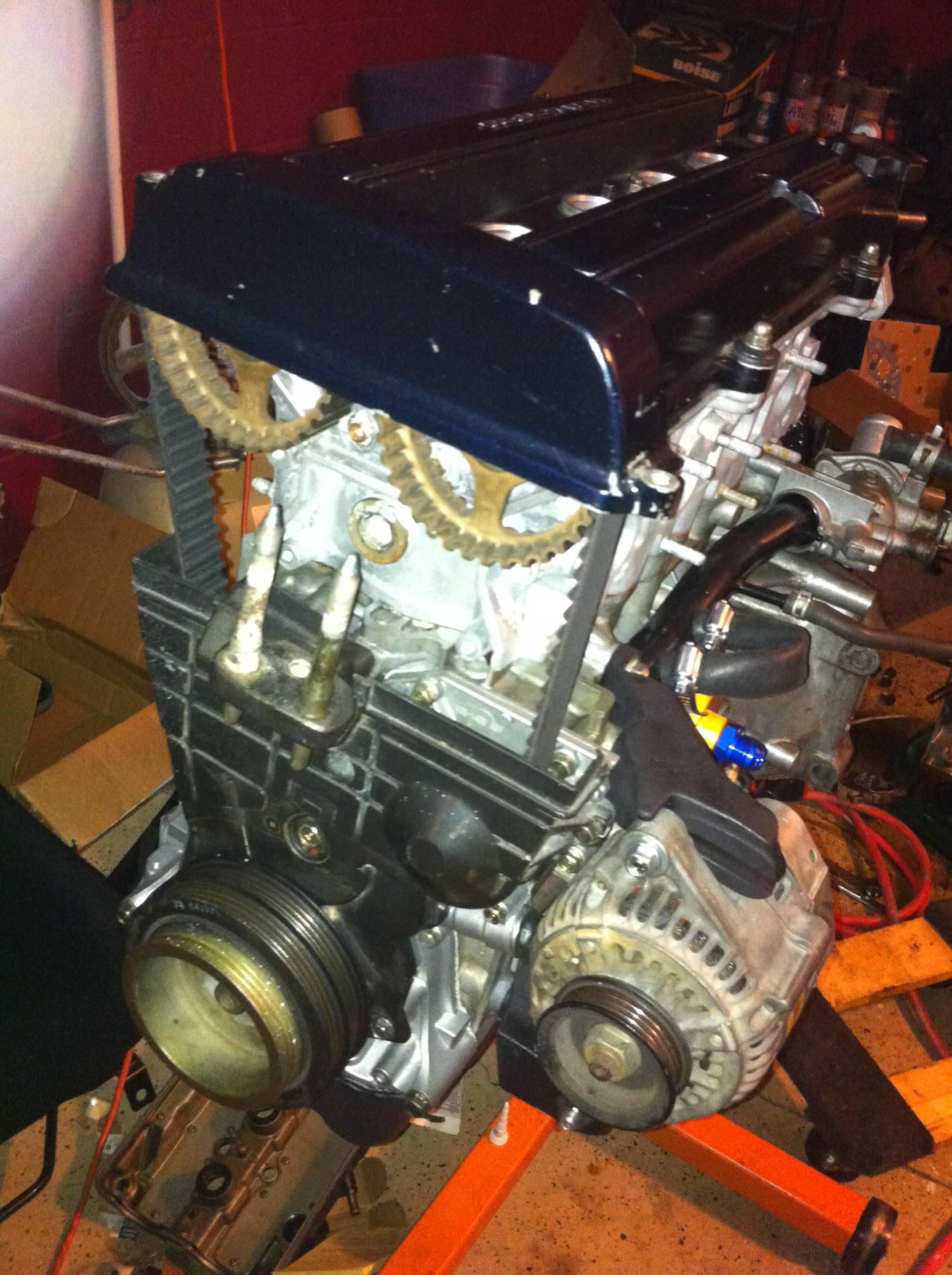

Starting the valve adjustment .008 intake and .010 exhaust for these cams. Timing belt is on and the motor is pretty much perfect for timing. Im going with NGK platinum cheapo plugs with a heat range of 1 cooler at 6 for this motor due to the higher compression. I hope that works out. I basically will be going with a gsr/itr plug and stock gapping which is just a little ****** than the b18b normally.
So my nice valve adjustment tool is for a 10mm nut and the B18B has a 12mm nut so fail boat there. I went with the typical slave labor adjusting.
All buttoned up. I left the valve cover the same way I got it used so it doesnt look great but at this point I dont care, I can paint it later.
So I just need to get it off the stand now, if I cant get some help I might just lift it myself.
I need to get a smaller alternator belt, I want it as short as possible for less work albeit little for the motor. I currently have a 30.5 inch so Im going to go with a 29.5 and see if that has it almost as short as possible.

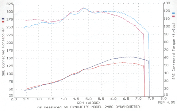

I was looking on Brian Crower today and it looks like the dyno for these cams with stock compression made a little over 150whp and 125 trq so if all goes well maybe I will be a little above that.
Their dyno chart they showed with mods aem cai intake, msd ignition, zero'd out cam gears, 4-2-1 header.
