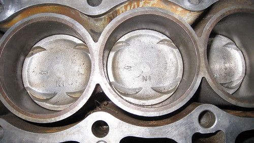

I bought a zc vtec with eagle rods and unknown pistons. He guy I bought it from never had a chance to finish the project because of personal issues so he sold it cheap to me. The thing is I cant find what pistons these are. There disc pistons from the looks of them. They look like vitaras but not.
The stamp on the top is 11-670 0T
Help me out..:D

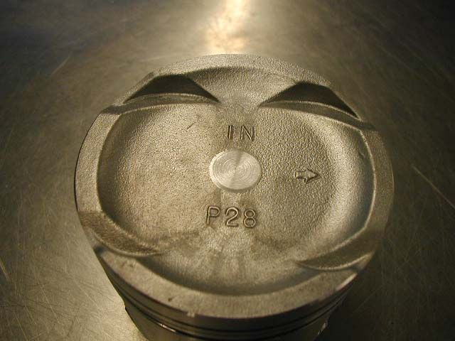

Couldn't be Vitara pistons; the valve reliefs on those look to be the same size.
Z6 pistons:
Yeah from what I can gather they look to be stock ZC pistons. The same as the American version Z6's.
