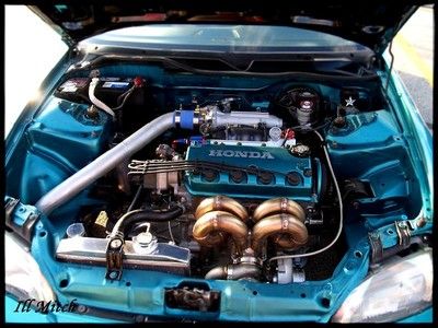

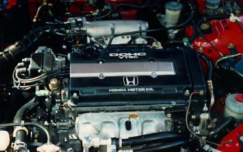

    eg2 means it is a vtec, but it wont tell you if its a d16 or b16. pop the hood and youll know immediately.
    the valve covers give it away immediately.
    top is the d16z6, bottom is the b16a3.

    also if your standing in front of the car, look underneath the distributor. theres a flat spot on the motor and thats where the engine stamp is.
    but yeah if its a b16 the valve cover will say dohc vtec
    unless its been taken off there should also be a sticker on the trunk that says dohc vtec
