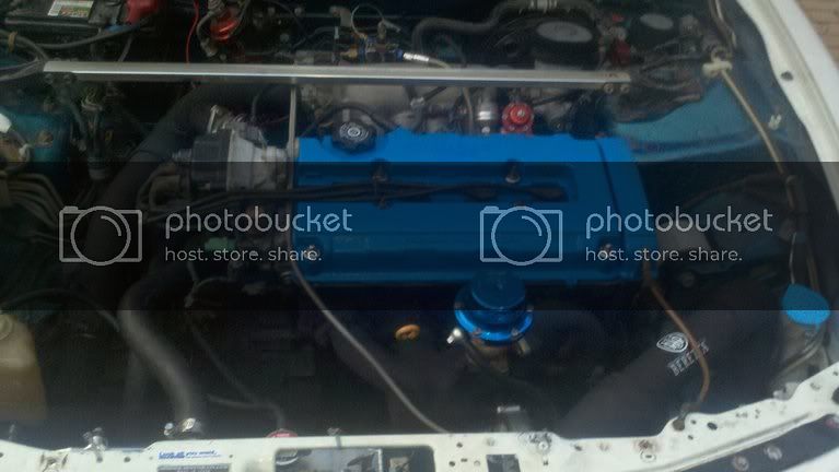

okay, I am looking to make some more power for this upcomming season with my 94integra, b18c5
bone stock engine
china 50trim
cast manifold
it currently makes (on crome), mustang dyno
-6 psi
-300hp/200tq.
-8500rpm RL
-19deg. timing
-11.5-12.2 A/F

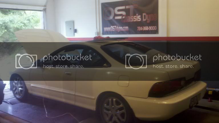

OST dyno in harmony, PA
look em up! its my buddys shop, hes got a built ls vtec and i dont even think he knows how much it is making lol, i think last time he checked it was at 460 or so and the clutch started slipping at like 6k lol
check out the pics of the customer cars
Dyno <<link to OST
