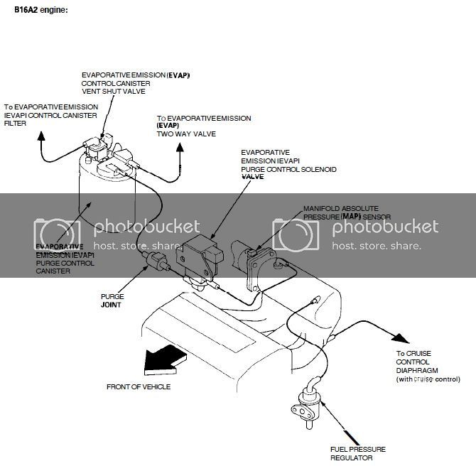

Check your purge solenoid, it seem it has a short.
His purge solenoid is not like the one in the picture....unless its a different OBD than I had. I had a OBD1 B16A in a 92 Civic Si and the evap purge solenoid (USDM uses the sensor but JDM didn't) is on the IM near the firewall on the driver's side (left hand drive). It does have a clip from the engine harness but its the same as the 95 EX (D16Z6) harness......plugs right up.

Did you accidentally switch the evap purge and the IAT sensors? They are the same plug type and close to one another.

About the plugs ur right there the same plug how will I noe which one goes to the correct plug??
I did it when I first put it in and I threw a code.....I thought they might be switched and switched them around......no more code.
