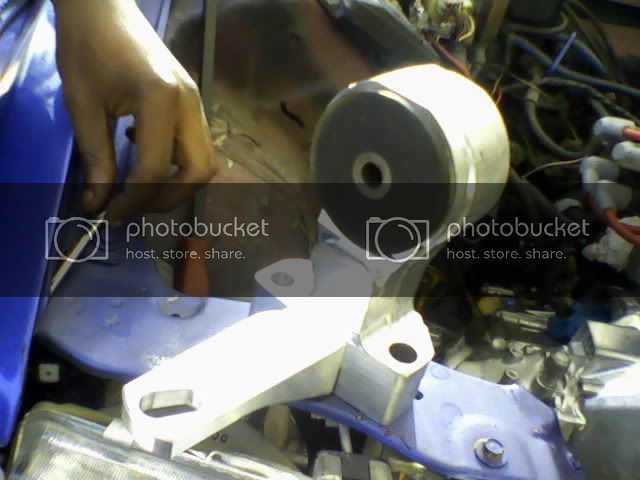

1st. is the rear mount im not sure if its the right one or what? it fits perfect with no banging down the cross member. heres a pic.

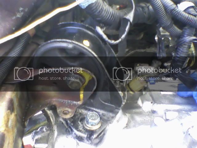

2nd. is which mount is this? where does it need to be placed?

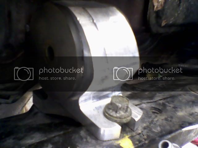

3rd. this is the top tranny mount, its pretty crooked!..but i believe its the stock mount from a 90-93 integra. which mount would i need to get to have it line up right?
advice for the 1st: the only way I could get either of my b16s in was to put the mount with the rear bracket in after the motor was in. then I put the rear mount in. I always take the rear bracet off because I dont want to mess anything up on the firewall when dropping it in. with the 2nd pic: thats the trans mount, but whether its the one you need or not, I wouldnt be able to tell ya unless I was there. and that 3rd pic really doesnt look safe lol, hopefully the mount from pic 2 is the one you need. good luck
picture 1 does appear to be the correct rear bracket. picture 2 is a side tranny mount for a cable trans into an EF. from the picture i cant tell if that is a cable or hydro trans you have though. if you have a hydro transmission then you need a hydro mount.
thanks for the info guys, i believe its a cable, in the book it said something about 3holes on the top of the tranny and it matched the picture when i looked at it, so i think i might have a hydro mount instead of a cable tranny mount maybe?..thanks for the help tho guys!!
