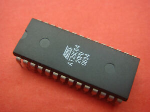

    eeprom chips can have many legs. i wouldn't go by leg count as an identifier.
    try to find the correct chip's code. it will look something like this:
