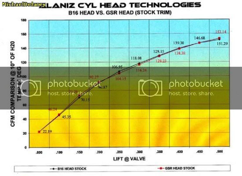

IIRC, Import Builders posted up a flow chart though this is all I can dig up:
Here's at 10" vacuum:
how abt these 2 brothers quit argueing, if i remember the comparisons correctly the difference in the heads on the flow chart is sooo insignificant it doesnt really matter
The arguement is over like i stated a few post ago.. but it was just a topic i wanted to throw out to just get some opinions. this was just all started over cause we put a b16 head on a gsr block due to the gsr head was messed up, but we had the b16 head PnP gasket matched. To me i don't really care the are both good heads, and from the charts that tells me the are both damn near the same.
Flow is the same; but you get a bump in compression with the GSR head which certainly means more power.

Built they can still flow the same; the GSR will still have more compression. The combustion chamber is smaller. Do you get it yet?
