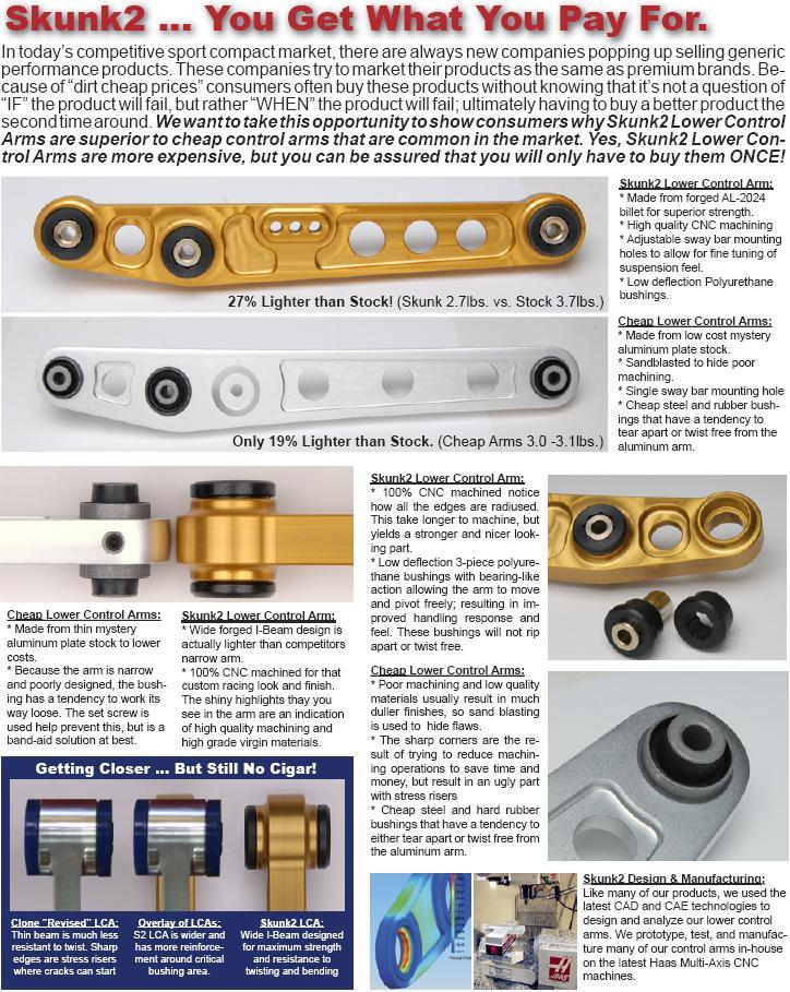

Made from stronger material, and they are much thicker. They are milled to be a car part, not a slab of aluminum with holes punched in it. Function 7 also makes some damn nice arms, but I believe they cost more than the SK2s
Read up:
the bushings on the BLOX products dont seem to last very long, folks swap out for ES bushings.
Nice phyre, now thats proof enough for me to buy skunk2 LCA's. I cant afford to keep replacing the LCA because of failed bushings.
