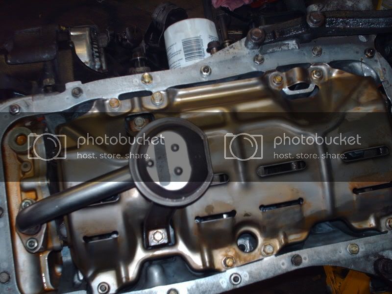

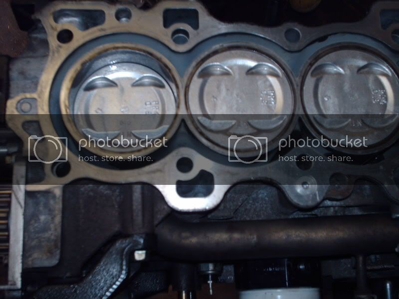

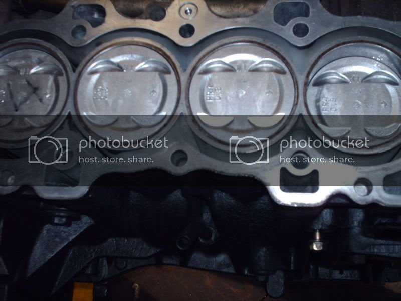

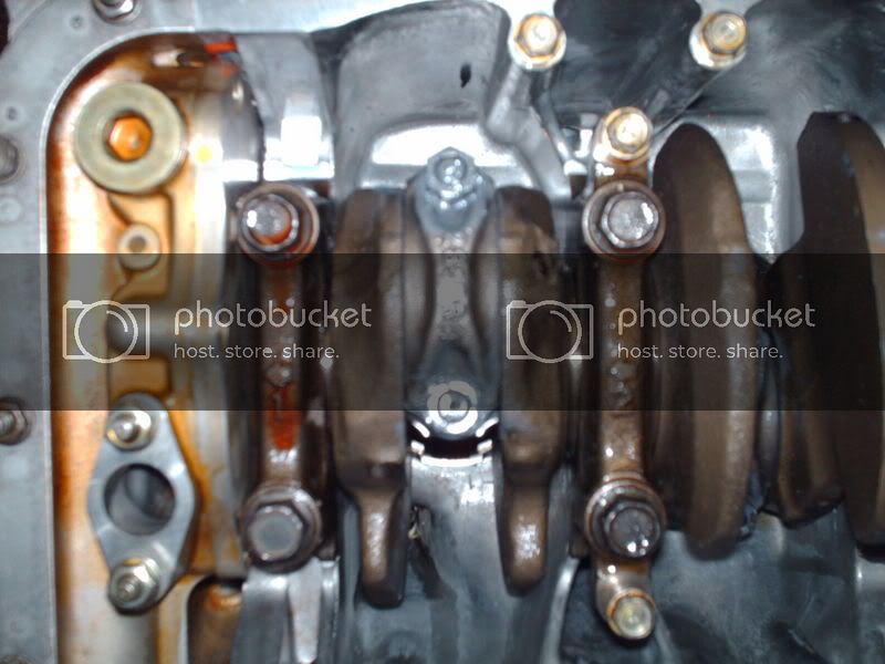

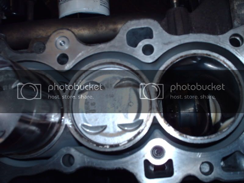

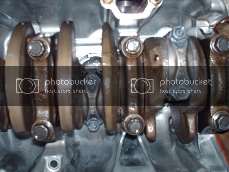

hers some picturs of the b18 bottom end -ls rods shot peaned ,pr4 b18 pistons,
polished ls crank,Arp rod bolts installed,big end of rods honed,block bored to 81.50 mm ,
the b16 head to come very soon,like tomorow.lol
