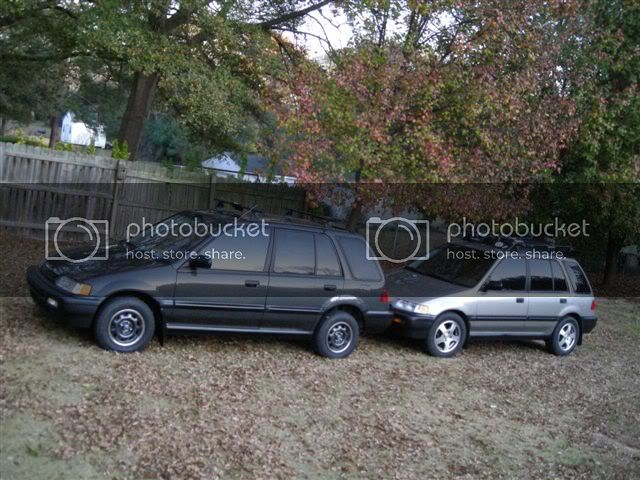

    Thanks for the welcome. I didn't mention above that the original car now has an EX trans., but still dpfi...that's the one getting the transplant.
    The darker gray one is my wife's, It's bone stock, I just built the D15b2 600 miles ago. It got 35, 36 mpg its first two tanks : ). Needs a transmission, it pops out of reverse and wants to grind in third. I have an Si box that I won't be needing for the Bwagon, and also the mpfi setup i was gonna use on mine, so it'll be getting a little love, too.
