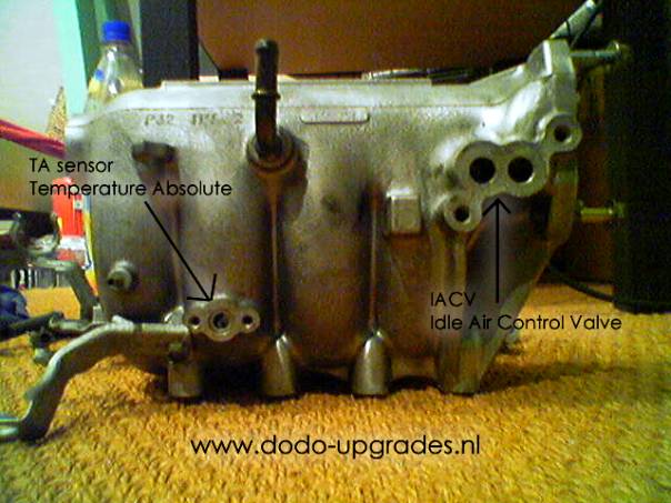

    so i sprayed IM TB every hose that connected to VC and IM and nothing so look in the car after reving it and it almost dying and now i have a code 10 IAT Sensor. now whitch one is that where is it loccated and can i us a used one are they modle/obd specific? thanks for te help

    Depending on the the engine... the IAT sensor is located on the #1 runner on the intake manifold. it could be on the side of the manifold or on the back.

    hhmmm none of those look right. its an auto if that would change anything #2/3 look the most correct but i dunno. this is the same plug as the iac? cuz if so mine is def on the back cuz i have three of the same plugs back there 1 is for the iac the other i dont remeber and one on the back of IM. is the sensor interchangable? does obd matter i have an obd0 manifold can i use that one? also have a z6 mani and a y7 thanks for the pics

    here... IAT location on the Z6 manifold. "TA" = "IAT" fyi
    Sorry for the wrong info earlier, I'm used to working with B series

    all is good my friend help is appeciated. D SERIES FTMFW!!:ph34r:
    but do u or any one know if they are interchangeable? n if a used one will work(if good) or is it a have to be new situation.
