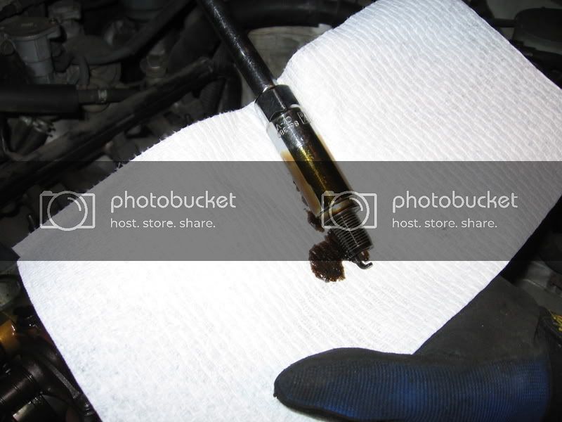

Well, I pulled off the valve cover on #2 tonight. I didn't see anything in there that looked abnormal. Then again, I've already said I'm no mechanic by any means. I pulled the spark plugs too and wow... LOTS of oil in those tubes, it nearly covered my socket! After the first one came out like that I had the wife snap a couple pics as I took them out. My guess is the spark plug tube seals were/are pretty much shot. That is unless anyone has any other ideas as to why they would be full of oil??
I also had her snap a couple photos of the valve train while she was snapping.
Here's the pics.... Does anyone see anything that should or shouldn't be there? I know it's probably hard to tell from pics.
I'm not sure how tight those little springs between the rocker arms are supposed to be (not the valve springs) but I can easily slide the rocker arms from left to right a little. Maybe thats normal movement but I thought it should have been tighter than that. I would have never thought there would be play in them like that. :dunno:
Spark plugs:

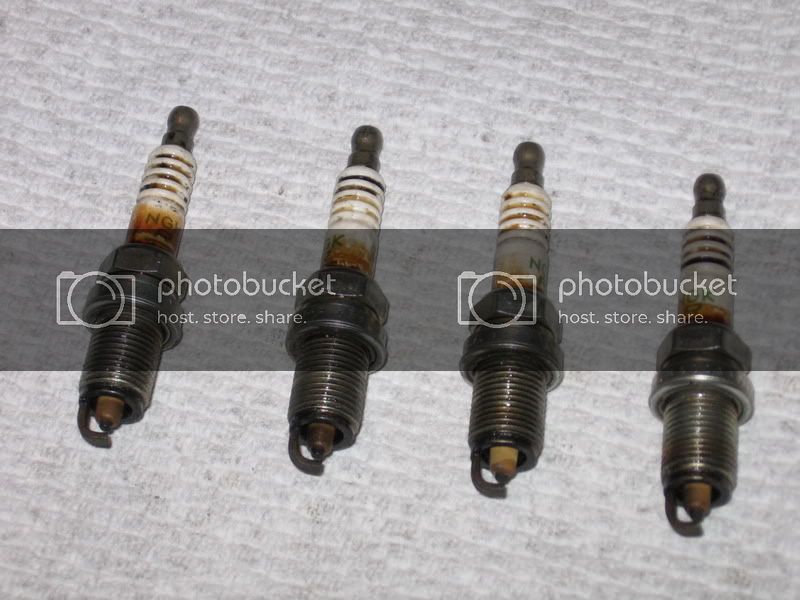

Here's all of them after I cleaned the oil off:
