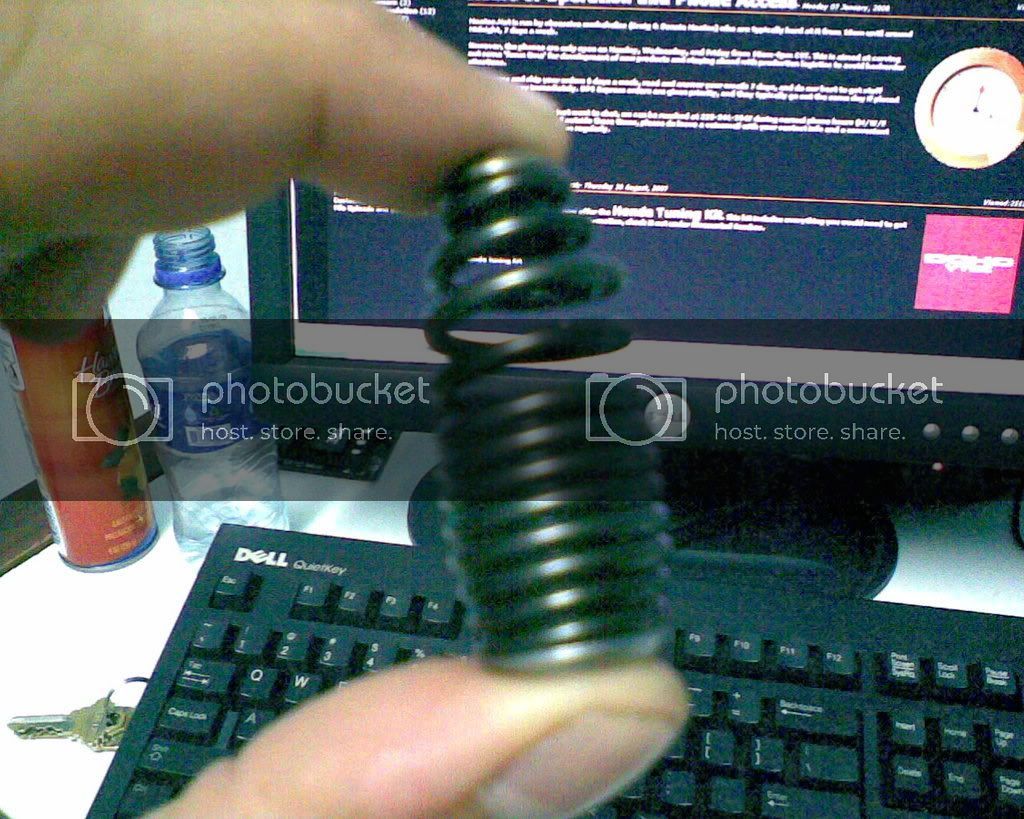

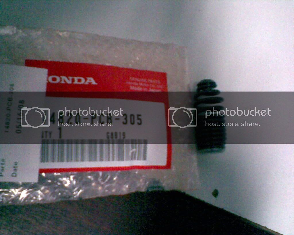

    I ordered lost motion assemblies from hondaautomotiveparts.com and they didn't send 14820-P30-010 , they sent 14820-PCB-305, I talked to them , and they said that they upgraded the lma's and everytime that you order 14820-p30-010, you will get the new ones, I don't know if they will work at all , and if they are good with forced induction ,,, I took a pic , take a look:

    looks like they changed the piston/cylinder absorbsion device to a spring. i would whole heartedly assume that would keep them from sticking (the main reason people replace em).

    I got PCB-003 ones that I've been trying to get rid of(H22 ones). They're suppose to be stiffer but require shims/washers.

    so K2e2vin, some honda LMAs are actually springs?
    the only ones i've ever seen are pictures of 14820-P73-J01 which look like what's at the bottom of this guy's cup of oil...

    The spring is inside ;)

    so are these new LMAs pictured the real deal? are they indeed an upgraded part from honda now?

    OK people , I changed the LMA's with the new spring design, the rocker arms are tighter than before , but I still have that weird sound , it's more quiet ,, but still there ! , I will use the car a couple of days and I will adjust the valve lash again
