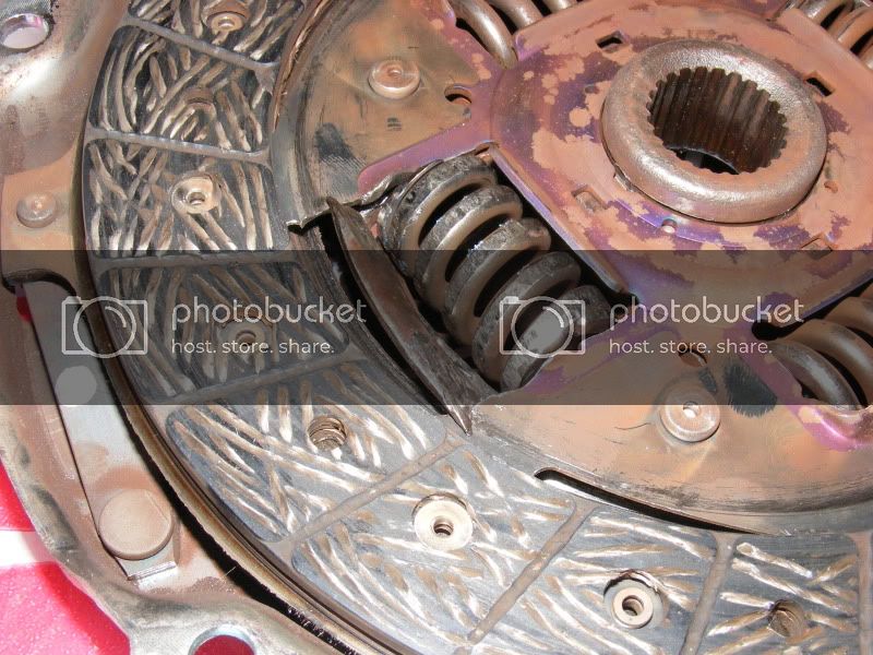

Hey guys! I finally found the problem....
I had a nice surprise when I removed my Pressure Plate...
So well...LOTS of headache for an exploded clutch. Who said Exedy was SO reliable? ^_^
They are reliable if installed currectly.. reusing clutches are a bad idea.. ive seen that happen to $50 clutches and $250 clutches.. its best to throw a new clutch in everytime the tranny gets dropped.. saves from doin work twice
Actually, the clutch wasn't worn out, it gripped perfectly.
I was changing the transmission because of grinding gears so I looked at the PP and it was all-good. Didn't bother with the clutch since it was O.K before doing the work, but I guess it was ''holding'' together with a little bit of luck.
Oh and if I had taken the time to remove that damn clutch...It would have saved me the trouble of dropping the transmission...3 times ;)
Anyway, I learned alot, gained experience, all toward my work since I just finished my mecanics classes.
