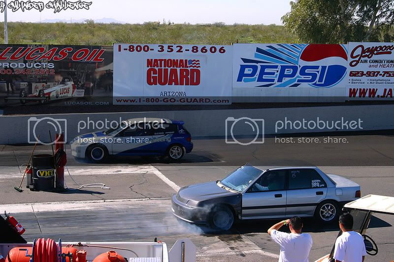

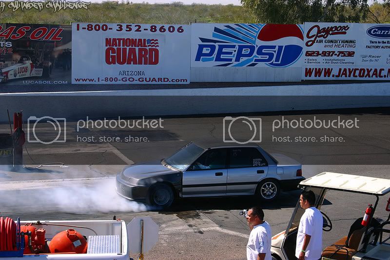

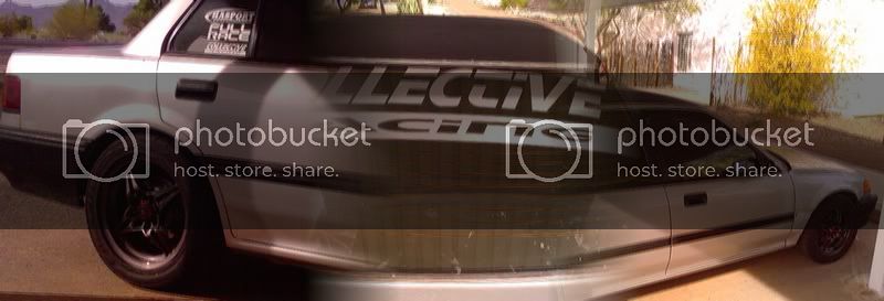

whats up fellas, New to this site, not new to the scene. just thought i would share some shots of one of my rides.
This is my street/race car.
Fastest time so far is 12.4 @ 110mph with a 1.658 60ft, N/A

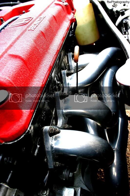

Welcome aboard. Details on your engine build would be nice.
Gsr head
3 angle port n polish
performance coated inside and out
Skunk2 stage 2 cams
skunk2 valve springs
type R valves, Heat treated and perfomance coated
skunk 2 pro cam gears
AN-R header
RC 310 injectors
Skunk2 Composite fuel rail
b20b block bored to 85mm
Rs machine dome top pistons
Cosmetic Head Gasket
Aebs intake manifold
70mm tb
Arp rod and head bolts
LS rods
LS crank Micropolished and HEAVILY knife edged
Type R oil pump
Ctr crank pulley
now for the trans...
97 spec JDM type r hydro trans, (jdm 99 SI gearset)
98+ type r 4.75 Final drive
Exedy Stage2 6 puck
8.8lb flywheel Crossfaced
Tuned on Neptune, Had some tuning issues so did not make max dyno pull
im sure i forgot sumtin, but thats my engine / tranny build

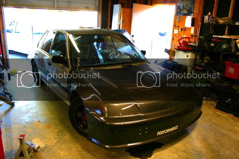

thank you fellas, weighed in at 1826 lbs with the fiberglass front end. NO metal cut what so ever. ALL door panels still in. DX model NO a/c heat component's.
is the interior gutted? other than the door panels? Man 4 doors are sick. But there is no way in hell that is a sleeper, the whole front end is redone.
i had 1 seat in it when i made my fastest pass to date in the car, its more sleeper when its on the street when the 1 piece isn't there and all the OEM parts are on it, as it is now. these shots are no more than 3 months old.
the 1 piece front end takes about 2 hours to switch out and put it back to stock and align everything.
