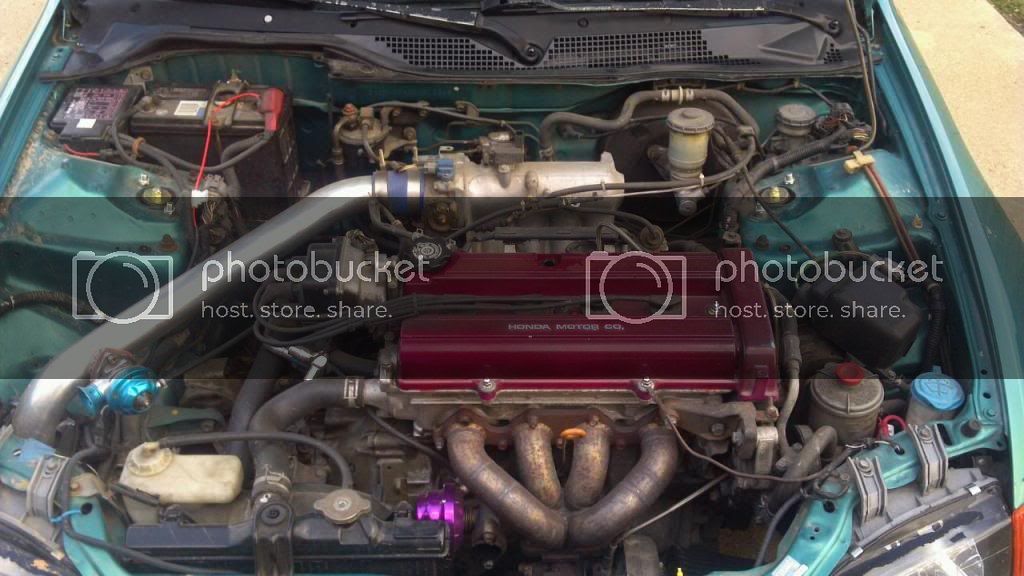

    So, I'm a v8 / mintrucker and I traded for this car and now I'm hooked. Problem is Im not sure exactly what I have. I'm new to driving with turbo and fwd. And I don't know anything about tuning these. I do have a good mechanic and machine shop and someone I've heard is a good tuner but I wouldn't know if any of em were lying to me lol. Ok, so, here's what I know. It's a 93 civic hatch si with a 98 integra b18 with a Garret t 60 @ 16 lbs. Tein adjustables f/b. Stock motor with arp head and rod bolts. Dyno but not street tune. but that just what I've been told but a lot of tuner guys around here are impressed so I decided to do some research and this is where I ended up. So... How can I tell which b18 it is? Which motor and head is it? What can I do and how should it be setup and tuned? What's right and wrong? What's it worth? Any driving tips, pix, info, opinions, anything would be helpful... Thanx guys. I was told it was 312 crank and 292wheel hp and 222 torque, 134 on 205/50/15 falkens and 12.7 on drag radials

    "how can i tell which b18 it is?" on the front of the motor right near where the trans bolts up you will see an engine code. if it says b18aX or b18bX (X being a number) then you have a motor out of an Integra LS (nonVtec) they have low compression and are very popularly boosted.
    if it says B18C1 it is a GSR vtec motor, if it says B18C5 then it is an Integra type R Vtec motor. and if it says B18C then it is the Japanese gsr or type R motor.
    Another way you can tell is to look at the valve cover. if it says Vtec then its a Vtec motor.

    I got a p75-6 head... Any info on how that affects my setup?

    And I can only read b18 on my block and it has a y with a line under it and under the b18 I can see a 5somethin an below that is h somethin but it's all ground out for the waste gate. Anyway I could figure it out? And the serial number on the head don't have a way to break it down?

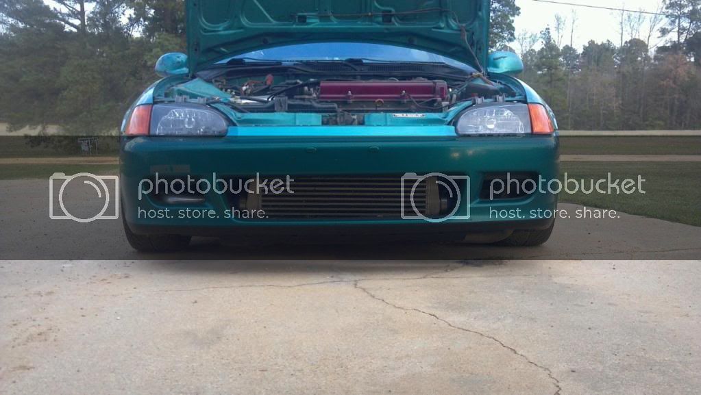

  8. Spaz337
    Spaz337 New Member
    12
    Apr 4, 2012
    I got rid of the mudflaps and painted the wheels flat black... I know I could make more money with fuscia wheels but I would have to run a chick over to be able to pick her up in this car with those wheels lol. Anybody got any tips on shifting and shift points with turbo. I shift fast and it bogs and I just slowed down and stared easing into it and slowly spooling into the gear but it's so slow. Where am I messing up? I'm used to low end torque. I was told to hold it in the red but I'm scared lol. Also, lookin for tires/wheels, comments please. I'm sorry if I'm asking a lot but I understand I'm not gonna get an answer for each but if you know something about the subject let me know. Any opinions are appreciated, good or bad

    Judging by the valve cover, you have a B18B1 (comes out of a 94-01 Integra LS). As far as shift points, I shifted my LS at around 7k, I wouldn't imagine youd need to go any higher than that.

    The valve cover is off a non-VTEC OBD2
    P75 is stamped on the B18B head and B20.. Not sure about the "P75-6. But it could be a B20 longblock with a B18B intake manifold. In any event....they don't flow up on top end like B18C's and B16's

    Damn! So what all would have to be done to the bottom end to accept the vtech? What's the deal with vtech? Somebody said it was like a two stroke powerband... You know how those racing myths are though lol can somebody lay down the differences in all these motors and where do you all learn these things? I can't find crap about these accept on here. Thanx guys! I really appreciate your input. One more thing, if you notice in my pic the vent line on the valve cover is not hooked up. I assumed it went to the intake nipple directly across from it but they have that ran somewhere else and theres a sensor or module or something mounted on the top of it with no vacuum or wire plugged in. Any info would be greatly appreciated. Once again, thanx guys
