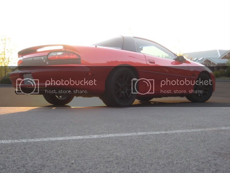

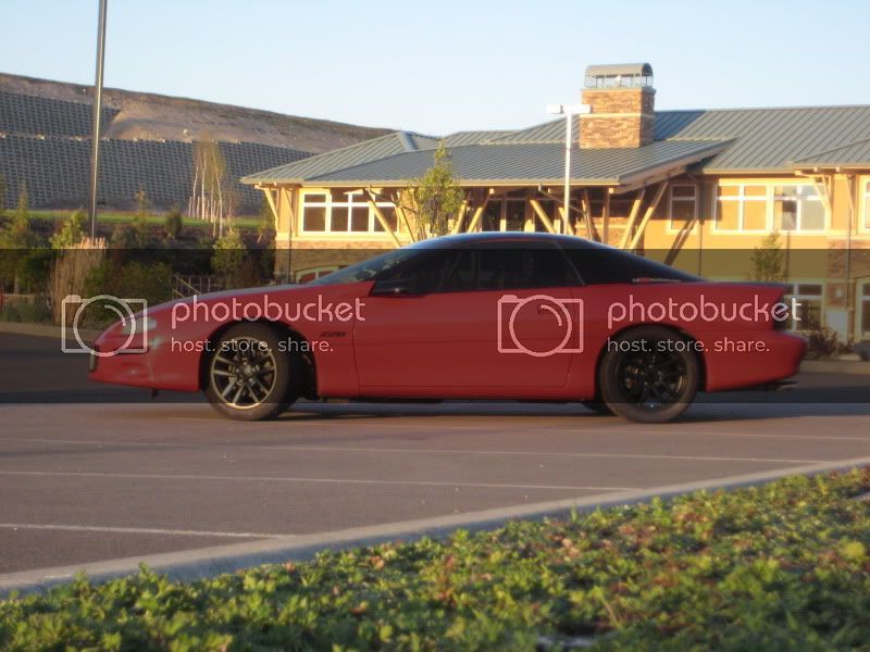

No new updates, but I took it out for some pics.
Tried gettin it out to the track a few weeks ago, but I missed registration by 20 minutes. They werent takin bribes either lol. Weathers been shitty and Ive been a bit tight on cash so I havent tried again yet. Hopin for a 13 flat at best. Shouldnt be too far off, thats for sure.

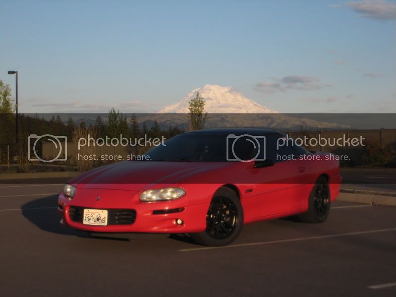

He lives in the northwest where they have mountains... unlike Kansas.
Lol, the stickers stay.
Werd. Im in the Northwest, and that would Mt. Rainier in the back ground. That one damn tree f'ed my shot up tho. Im still huntin a spot to get a clear view of the mountain.

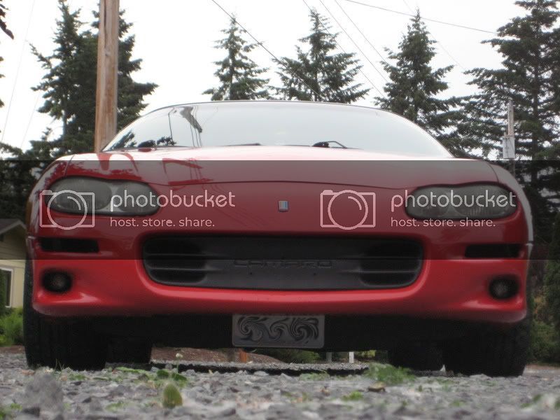

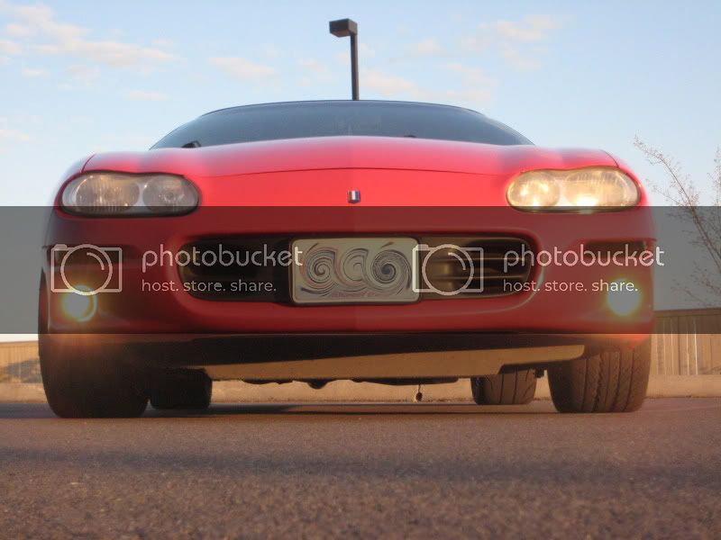

Well, its been slow but I finally got around to movin my license plate. Looks a ton better, and its still somewhat legal. If it really comes down to it I can still put it back in the factory location easily so its all good.
Before
After

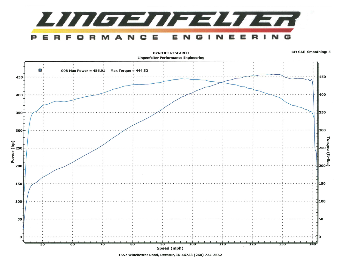

Should just sent your car to Lingenfelter ---bam--done..
Camaro/Firebird 1998-2002 > 427 CID LS1 7.0 L
530 BHP / 530 lbs-ft of torque
See chassis dyno sheet MT
