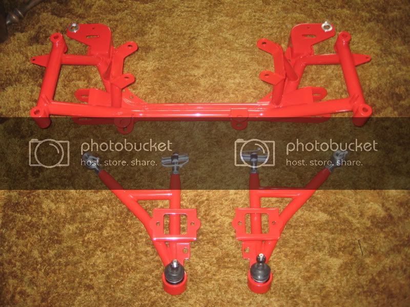

K-member damage.
I thought the drivers side LCA was toast, but the K-member was just worse than I thought. Either way, I already ordered a tubular K-member and LCA's. The shipment is all fucked up. UMI told me 1-3 days. Fedex says a week and a half, but thanks to the storms on the east coast the packages are behind schedule.
