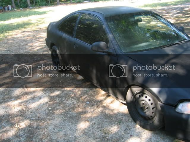

so i just bought a project car
i got a 95 civic dx with a d16z6 swap
owner said he added:
-performance intake manifold
-looks like a bigger fuel rail
-cam
-reactive headers (they r on there i can see that)
-high flow cat
-3" pipes to a apexi muffler
-lsd auto tranny
- and all the interior is pretty much gutted, no ac
-all mods done by owner, who is a chevy mechanic :eek:
but my problem is....this thing doesnt move like it should
anyone recomend any shops around raleigh NC that could tune this thing to be
better without throwing a manual tranny and turbo on this thing?
and i will post of pix of this machine in a while
this is my first post. i love the forum lots a great info
thanks in advance for any help

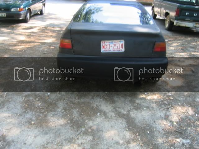

replace the trunk.

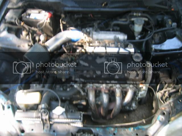

why does the engine look crooked?

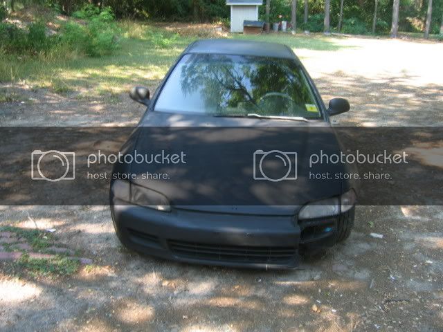

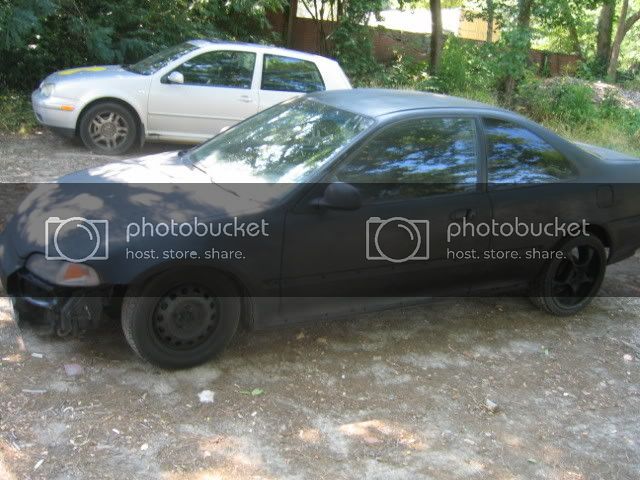

the bodys not that bad. just replace the trunk and front bumpercover, fix the passengerside shave job and make the driverside match.
it'll be decent.

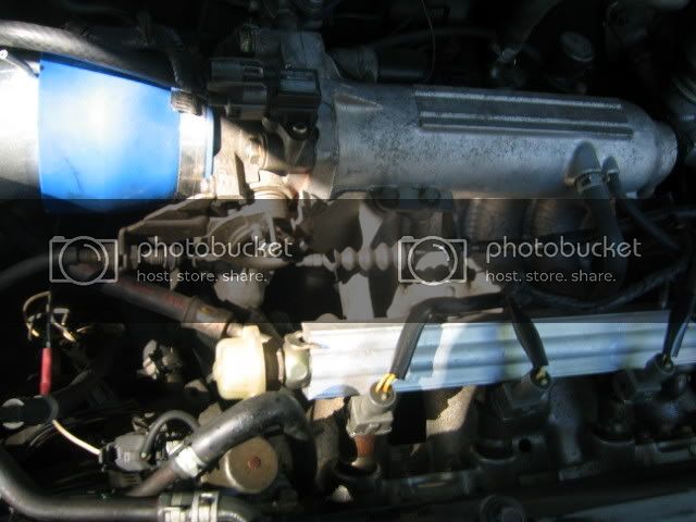

-performance intake manifold --- looks like the stock intake D16Z6 manifold to me
-looks like a bigger fuel rail --- again, its stock
-cam --- bullshit
-reactive headers (they r on there i can see that) --- yes, they are there, but they suck
-high flow cat --- bullshit
-3" pipes to a apexi muffler --- bullshit, with a side of whats the F'n point, the ractive header has at best a 2.25 outlet, also a 3" exhaust on a NA car will fucking kill any sort of power you might think about having
-lsd auto tranny --- BULLSHIT,

Stare at the far left top header stud and let your eyes drift in and out of focus, I swear to god the image starts warping. Sweet Jesus save my soul.

you should clean up the outside first. not because it's ugly, but because it's going to catch attention from cops. that thing will get you in trouble.
x2 i paid 1k for my eg and its in better condition than yours and i am not pleased but i guess if you are happy thats what matters most get it cleaned and painted and work on the engine
haha weight reduction first. take off that trunk with 50lbs of bondo on it. that'll speed you up.
