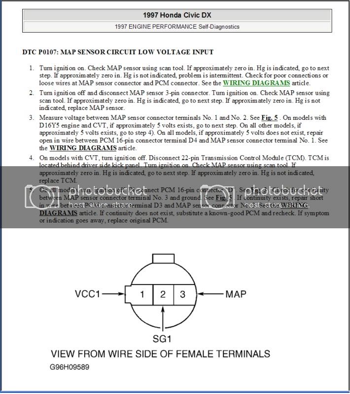

If you have no codes, do you have access to a Multimeter?
If you do, I will send you the procedures to verify your MAP sensor and confirm that it is the actual problem.
Otherwise, get your car scanned, the problem might be intermittent or it might be something else.
Good Luck
This is what you need to check for your MAP. Never mind the scan tools and the PCM connector. Just check that your 5 volt signal is actually there and that you do not have an open wire, or loose connection.
