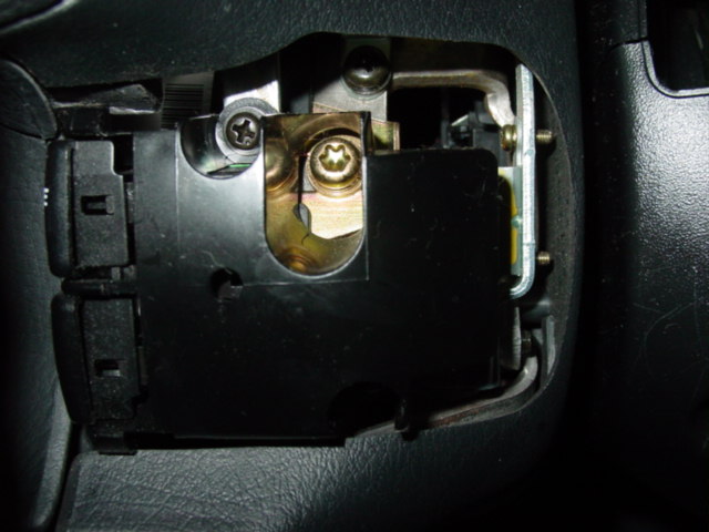

Start by removing the caps on either side of the steering wheel. Remove the torx screws found under the caps.
With the screws out, the airbag is ready to be removed.

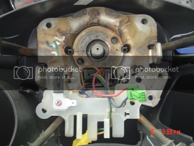

After you remove the airbag, remove the 19mm bolt in the middle.
Removing the wheel is as easy as wiggling it until it pops off.

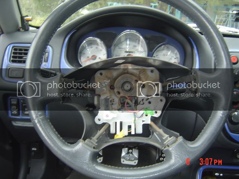

Help, trying to put on my new wheel but the old one won't come off, every forum, every thread about removing the stock wheel just says wiggle it and it should come off but mine won't budge...however all post I think were relevant to the 92-95 civics. Is there anything particular to the EM1's? I got this far
Yea everything is, been tugging to the point where the entire car is rocking, does it matter if the wheel is locked?
hers wasnt locked when i took it off earlier.. i had the whole thing done in 20 min.. rather simple
Yea, I had everything disassembled in 10 then hit his bump, let me go insert the key to unlock it see if that makes a difference
Aight, it's off, had adjusted the tilt alway the way up so I could see underneath when I was disconnecting the airbag. Soon as I put it back down, the wheel popped off in my hands
