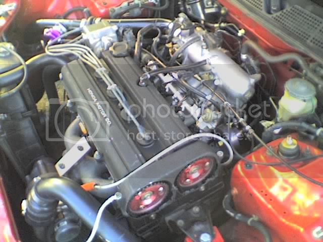

Its a 97 LS overbored to 84mm b20z pistons on Ls rods ARP rod bolts,head studs. DId a minor p&p on head, port matched IM, crower Ls402 cams w/ Ti. valvetrain. All work was done by me including turbo kit, so far 10psi with OEM Integra Type R fuel Pump, FUel rail, injectors and a cheap 8:1 FMu only one CEL, and a lot of kills down the line the motor is doing good.

THe Cel i got was the Map sensor, running the ghetto fuel supply for a turbo (FMU/missing link) boost spiked by 3 psi i think on a 4th and 5th gear freeway pull to just over 140mph trying to leave my Gf's brand new M3. Didnt work as i saw the CEL flash boy did i let off quick.
