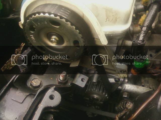

well today is gonna end in epic fail i believe, this crx that i bought a week agos timing belt decides to walk off the pully at about 2k at 65mph going down the highway, hope all the valves arent bent, if soo im FOoooKed, cause its my DD, fucking buillshit

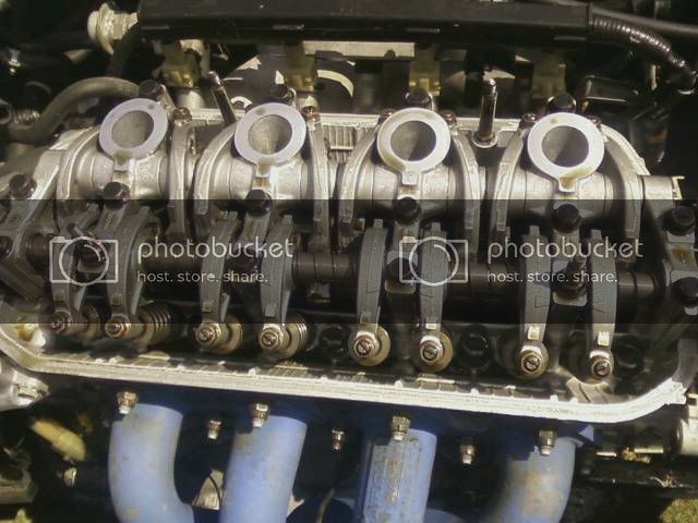

Valve Cover Off

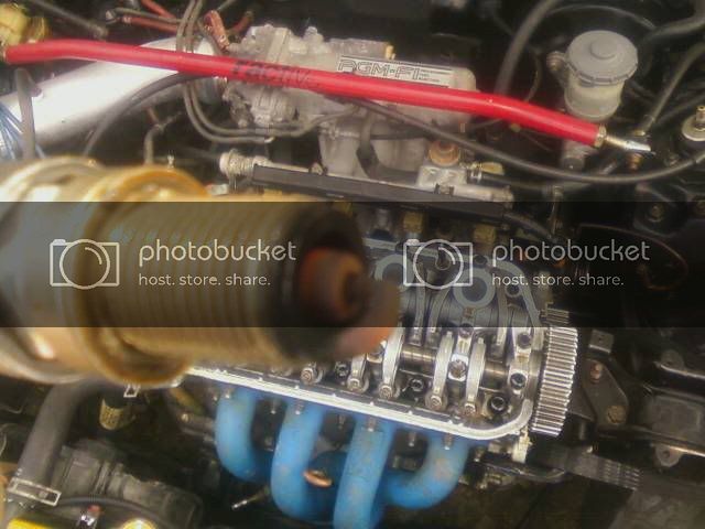

Plug Looks fine

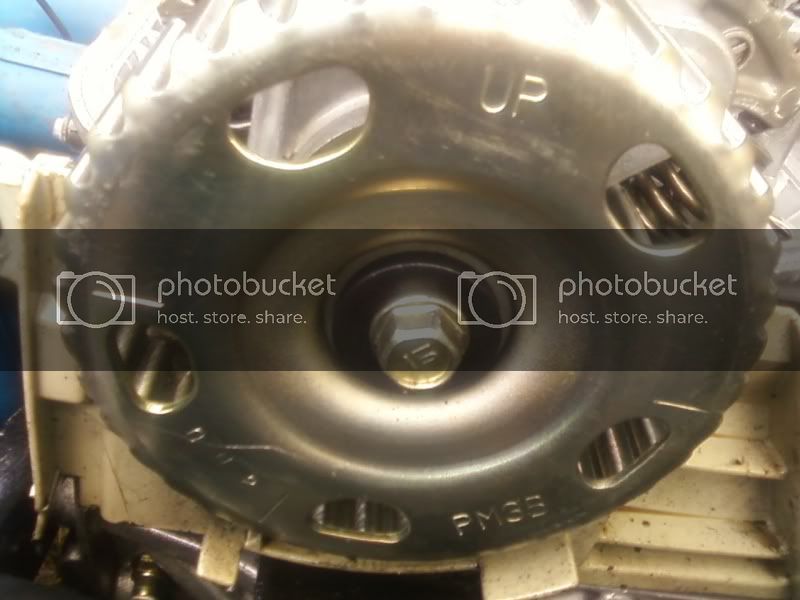

Abt 1 tooth off tdc (fixed before timing belt was put back on)
Timing belt back on :) All TDC
