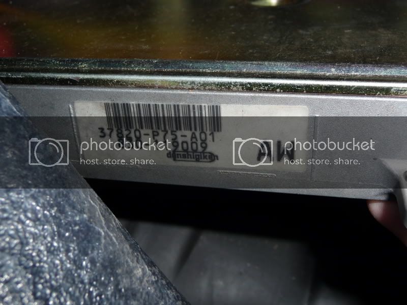

    I dont have a CEL, or anything else. I Passed my visual and functional. But how cna you tell why type of ECU you are running? I tried to find some way to identify it, but all it had was a sticker with a bunch of numbers.:confused:

    yeah the white sticker. it should read something like XXXX-YYY-ZZZ
    your interested in the 3 numbers/letter where the Ys are.

    Thanks. I have a P75, so i have the right computer. I am hoping its just an o2 sensor.
