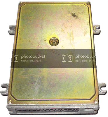

Well, for starters lets see what you have first. What color are the plugs on your fuel ingectors. Do you know what ECU you have? That would defentally tell us what OBD status you have. Does your ECU have a little clear circle on top of the case with a led light underneath it? Tell us what OBD status you have then we can tell you what to do for the GSR swap.

Yeah its OBD1. So I think all you have to do for the GSR motor is add the two wires for the IAB's which is easy. I'm not positive on this but other HondaSwap memberes can tell you. Hope that helps.:)
Oh and btw the ECU is under the passengers footwell, 4-10mm bolts takes it out.
that's the first place i looked its not there. its hidden somewhere in that car. I'm going to have a friend come over and we are going to keep looking for it. ill check one more time.
Is there a plate or something covering the ECU?
