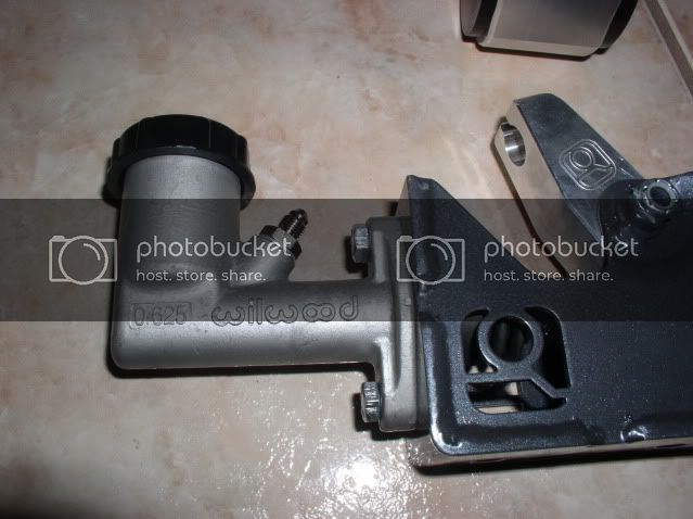

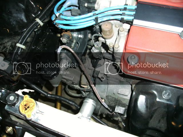

I had Neal Sutton wire my CRX from obd0 to obd1 but I will google the information for you and find you a good diagram. As for going from cable to hydro, I used the innovative cable to hydro conversion set up.
Here is a picture of it installed.
Here is a few pictures of it before it was isntalled.
