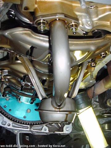

    I haven't delved into any internals work in my learning yet. So I can't visualize how that diagram should fit together really. More input?? Thanks!

    This should help. Pickup is below the tray as you can see. Drop the pan and its right there.

    oh wow that seems easy. thanks
