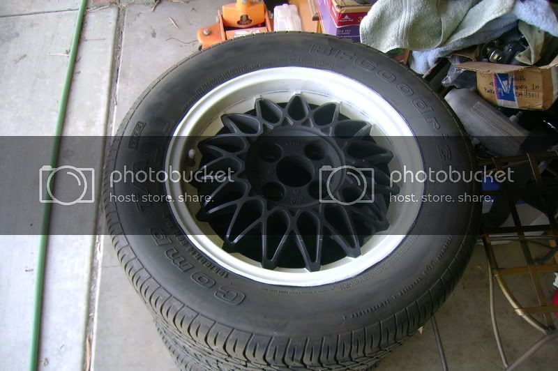

    alrighty, as some of you know i came up on some mesh wheels from a buddy of mine.. .not sure of origin but they're O.Z. wheels and looked like hell when i got them.. so i'm polishing the lip and painting the mesh bronze....

    before:

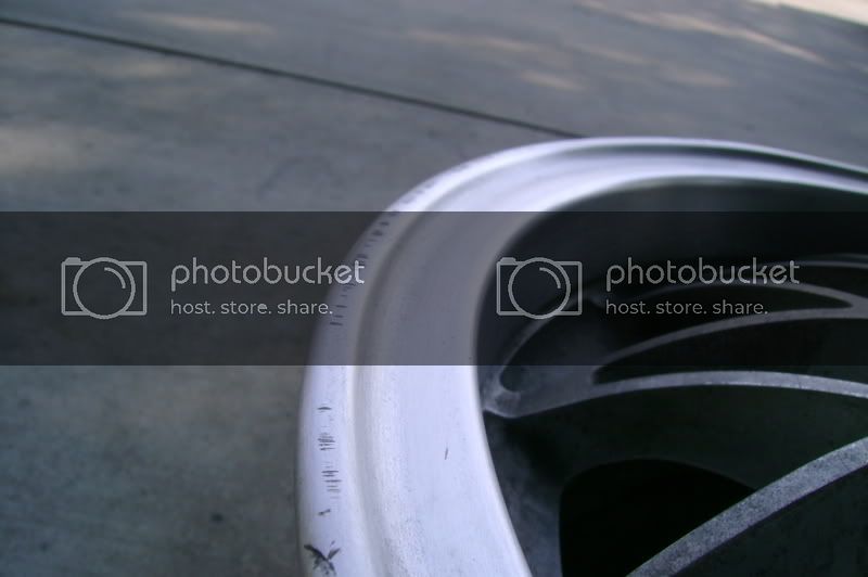

    here is one after being stripped of paint and steam washed..
    lookin a little better here..

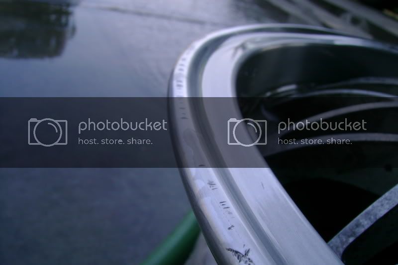

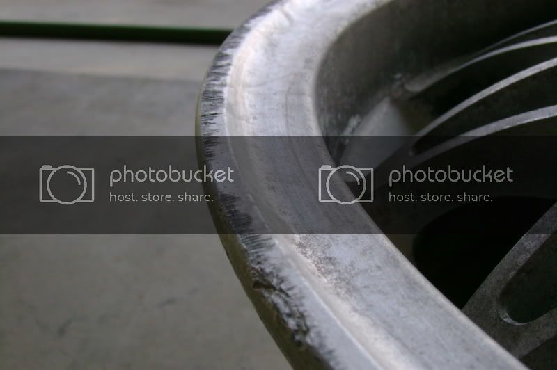

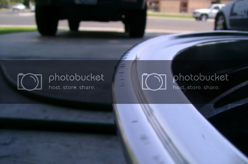

    here is one of the lips to begin with, using the curbage as a reference point...

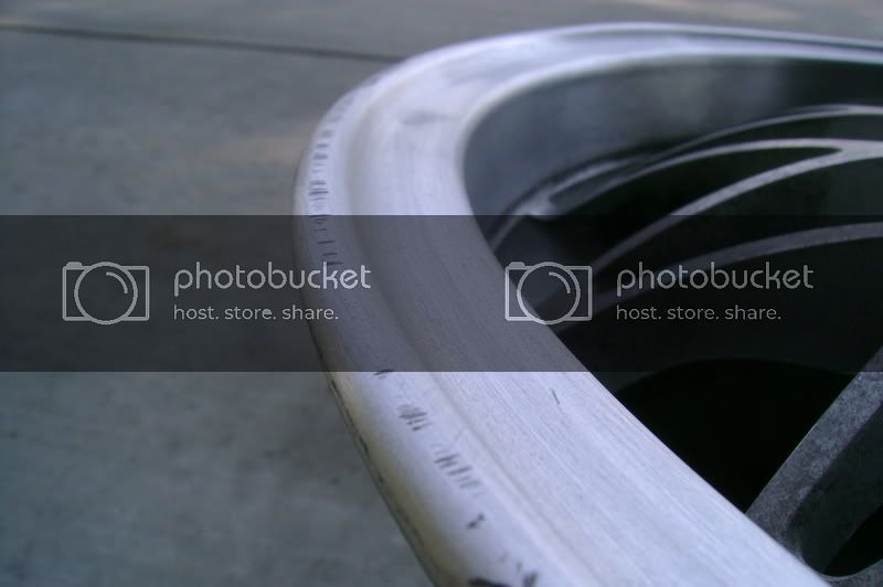

    this is after hitting it with 150 grit, you want to do this dry sanding (again, only needed for curbage or any other flaws)
    this is with 220 grit to cover the 150 grit grooves, dry sanding again

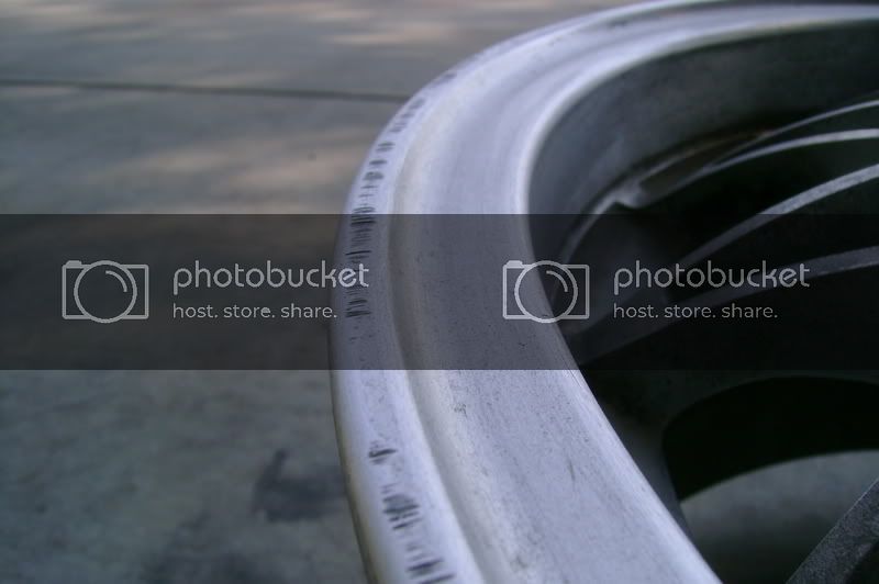

    320 grit, again dry sanding

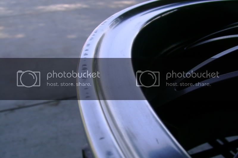

    1500 grit, wet sand.. water, water, water
    not too shiny yet.. how bout a little polish :D

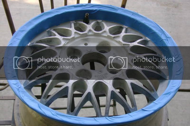

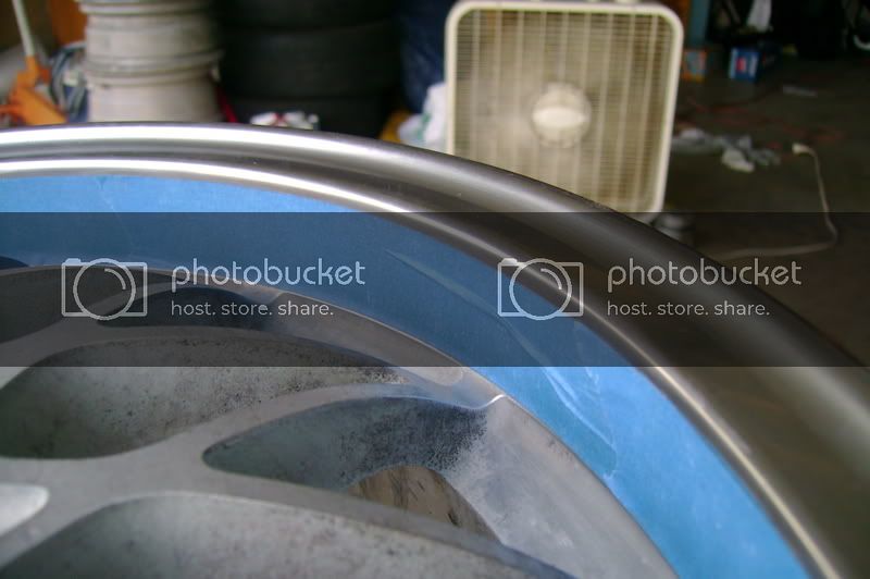

    now that the lip is nice and shiny, time to tape off the outer rim so no paint hits it.. like so..
    some people use newspaper and tape it.. its a hassle and rips.. so i use all tape.. :D

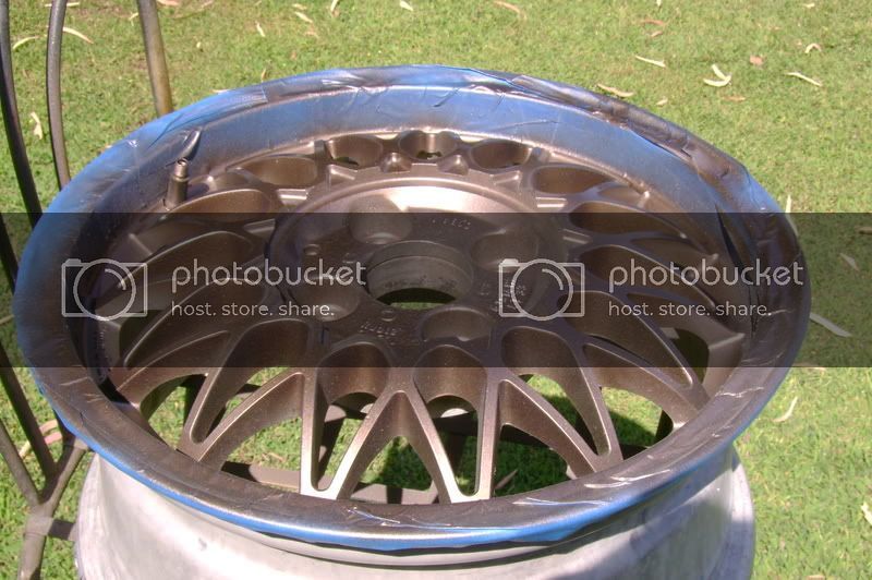

    time to apply paint/clear.. apply evenly (mine was difficult to do because getting in between the mesh isnt easy)......... place in sun and let it dry.. once dry, remove tape.. should look like this ..
    again referring back to the curbage.. this is as good as i could get it

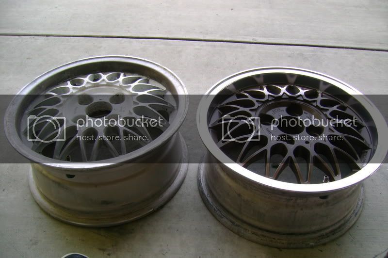

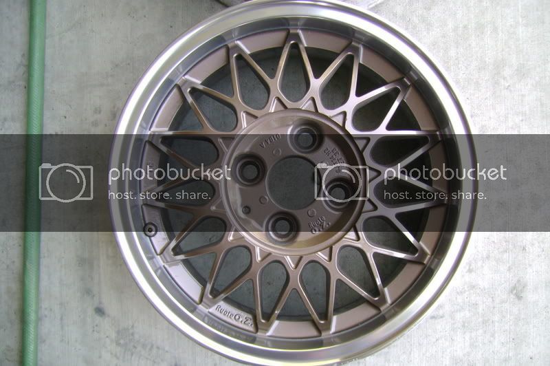

    and here is the outcome
    and now to the difference from before and after polish and paint...
    oooo.. notice the shine off that lip..
