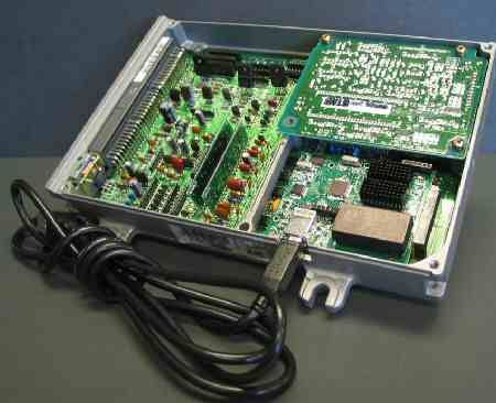

the s300 has a flash rom built onto it.
there are no chips.
So, basically it's an ostrich built into the ecu. I'll take a picture of my setup, and get a picture of hondata's s300 box.
Not my ostrich, but it's exactly the same.
No pic of the PM6, but it's a socketed PM6 with a serial port in the side of it.
The s300, a really clean setup for sure.
Hondata offers a good product for the price, but I got everything I need for about what it costs for just the s300 system. I will say that the hondata package is prettier, and has good software. But if I was obd1, I'd still take a socketed p30, an ostrich, a datalogging cable, an LC-1, and crome pro before I got hondata. Chris has some good prices, and is hella cool to deal with, speaking from personal experience.
