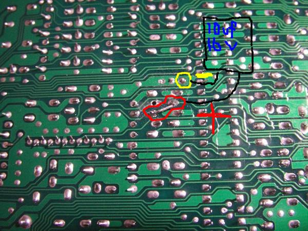

    my setup: p06 chipped and converted to p72 (adding vtec, and IAB's w/out a knockboard) and 5 volt output mod for wideband users

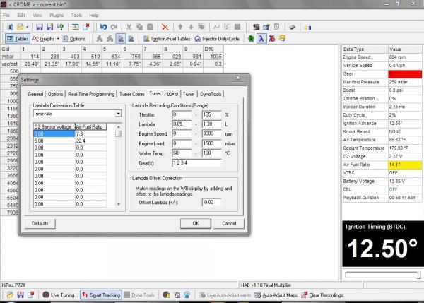

    I use crome pro with a ostrich 2.0, extreme hulog, burn2, and an innovate lc-1 with the digital guage.... and I have modded my ecu to read the 5 volt output from the wideband.., on the stock (d14) o2 input wire....
    I have configured autotune, and autoadjust maps to work perfectly... with the p72 rom with crome pro.... I have the HiResp72 rom that doesn't have the target lambda all redded out at the bottom.. (preventing auto tune at all)... anyway... you have questions..., I have answers.. If not, Im sure one of these other fine gentlemen with knowledge greater than my own will...
