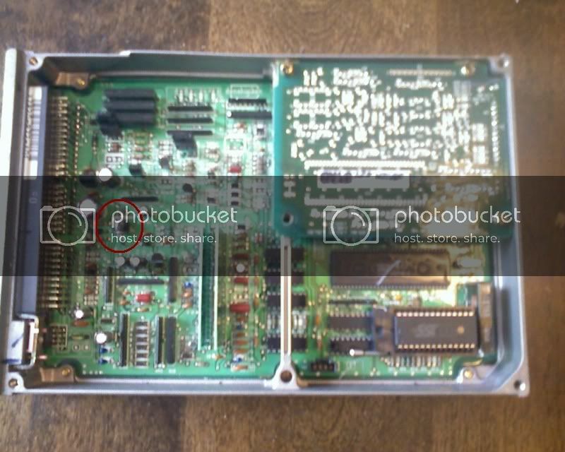

ok i have a crx converted to obd1 with a b17a1 da GSR, and a matching p61. ever since ive had the swap and ecu, my cars been throwing code 41. oxygen heater and ive tryed new o2 sensors, so i tested the o2 wires and its getting little to no voltage coming out of the ecu, so i took the cover off and i found this peice laying in there so i soldered the piece back in and it keeps blowing a fuse in the engine bay and wont start but when i take it out it starts just throw code is there i certain direction this piece has to go in, i have a pic of the piece, is this piece even the problem for the o2?

that looks like a diode. they are directional. i have never seen or done this on a ecu but its the same in heavy machinery. if there is not a arrow then try both ways. can also use a continuity tester to make sure its not blown
