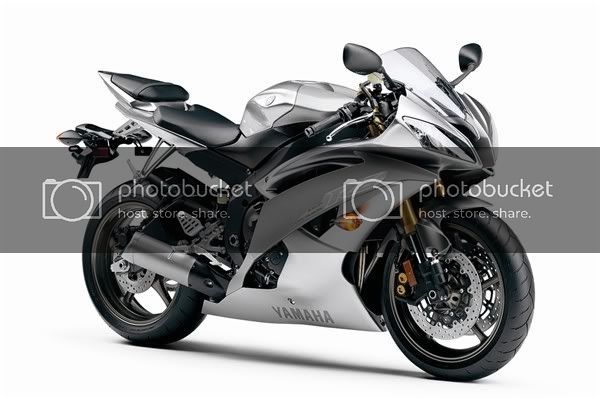

gunmetal. silver bikes are sick. or flat black.
gunmetal sounds pretty sweet now that i think about it. I was thinking a deep blue like the 2000si or yamahas blue. Pretty much its whatever i can find rattlecanned. I'll just clear coat it as well or find something that can resist gas a bit.
i would have gotten that color if it was out when i bought my bike.
It's at least reflective and most of my long distance riding will be at night. So I'm veering away from darker colors. Heck if shit brown with green specs kept me from getting hit I'd rock it.
