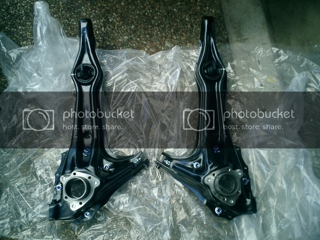

Here are my trailing arms
The part numbers for rear trailing arms without ABS is
LH = 52370-SR7-980
RH= 52371-SR7-980
The 4WD rear trailing arms are the same for both EG models and EK models.
Actually all 4WD parts are.
It will definately make things a lot easier if you plan on building an AWD K24 monster!
Good luck hope that helps.
emanuera- have you actually tried dry fitting the arms up to the car at all yet? I know a few peeps that have done the awd conversion using the genuine oem awd arms, but the arms are not a direct bolt up onto a non-awd car. They are longer overall and mounting points are different
so anyone that has access to the crv arms you may as well use those unless you specifically want to use the awd rear axles for whatever reason
No I haven't test fitted them yet, It's my girlfriends daily driver at the moment.
Yes I think you may very well be right, I also came to the conclusion the arms would be too long and would need to be shortened, but I have them now so I will use them, it doesn't matter what arms you use they will still have to be modified, I just didn't want to have 2 different trailing arms welded together like other similar builds, but each to their own, you can only do the best you can with the materials you have.

the real problem people have been running into with the arms is not so much that they are too long, but the lower control arm mounting point is further back 1" and will bind the arms. You either have to move the mounting point forward on the arm itself which then increases the chances that the control arm will interfere with the axle, or you can do what most people have done which is (eesh) separate the rear subframe from the car and move it 1" back.
Me personally, I think at this point I am going to wait till I have the funds to do it right and try to get a rear clip or crashed chassis shipped over here from NZ/JP/UK/etc. That way the only thing I'll have to do is drop in my K swap and modified rear end. No cutting, modifying, relocating, tunneling, etc etc.
