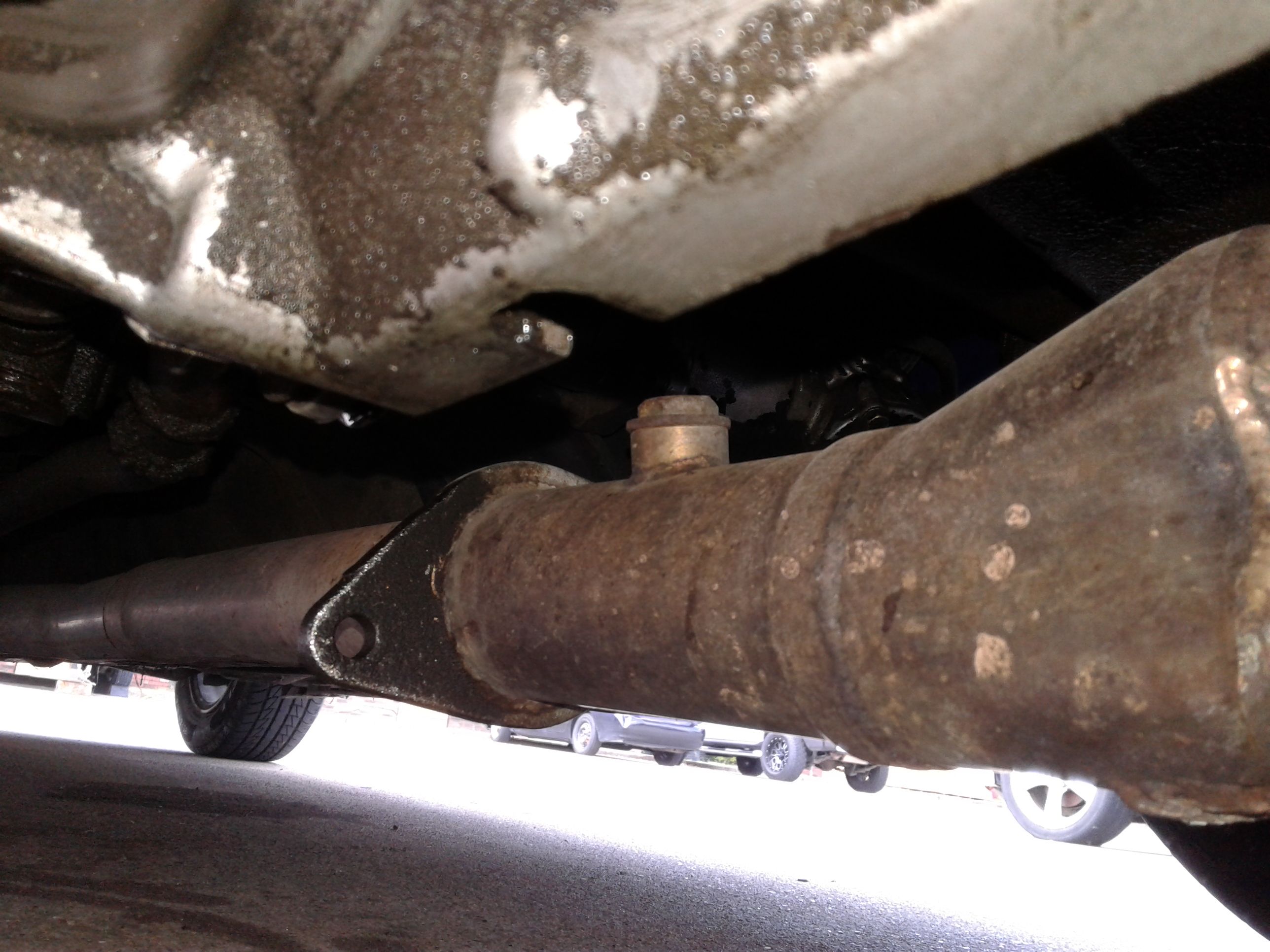

This is the only Bung on my exhaust system. Guessing this could be an issue? And is that accessible and/or able to be used by the tuner for the wideband or whatever. And also... do i need the o2 sensor and how do i install it. I mean is it easy enough for me with basic mechanic skills or should i take it to a shop.

This is the only Bung on my exhaust system. Guessing this could be an issue? And is that accessible and/or able to be used by the tuner for the wideband or whatever. And also... do i need the o2 sensor and how do i install it. I mean is it easy enough for me with basic mechanic skills or should i take it to a shop.View attachment 26281
Thanks for all your help.
no O2 sensor is not a good thing
means it is likely set up to run open loop (ie: rich as fuck at all times)
hard to say what would be involved in getting the sensor put back in there as there is a wire tuck and who the hell knows what they did
