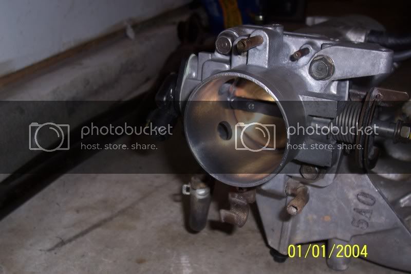

I taper mine out from the plate to the end some too but i do it by hand....drill and several steps with different stones, sanding wheels, polishing wheels, etc,etc....
This is the one on my LS....
You polished it up nice, taper the very end out to a thin rolled edge. You still have a thick edge there :)

like this T&A?
this was my b16 TB.. of course i didnt do it.. Maxbore did
64mm and i believe it tapered out to 66mm
Yeah man, thats the way :) The Matrix guys use maxbore as well. i think they bore the whole center and replace the plate, correct?
Damn, thats a monster! LOL! I just sold the power one I had, 68mm with a taper to 73mm. Wish I couldve used it first to say what a TB that size does for me :)
I noticed the only difference in mine and that one is I countersunk my screws and thinned all the way to the ends. I need to look at some more and see why they did that over what I did.
