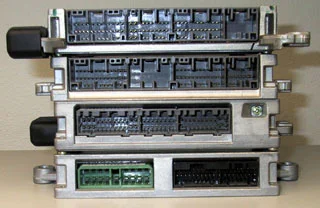

i checked the reference section and it says that PR4 ecus are OBD 0 and this auction says it's an OBD 1 ecu that came out of a 93 integra what's the story here can anyone verify this for me-

three gray plugs on the outside of the ecu, where the harness would plug in? beacuse it has that
Then it is OBD I, OBD 0 has two, a green and grey, and OBD II(B) has four.
I thought that the obd0 ('90-91) had a window with a LED on top of the ECU housing for the error codes. The obd1 ('92-93) has a remote plug for a jumper. Is this correct?
Also, this image depicts the differences between ECU generations. From top to bottom: OBD IIb, OBD II, OBD I and OBD 0.
